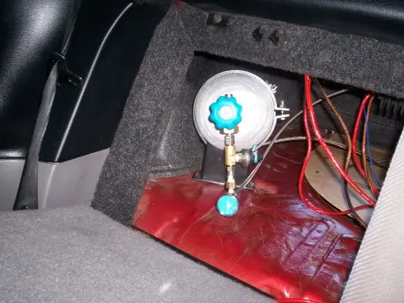

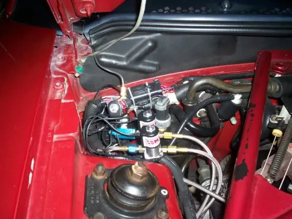

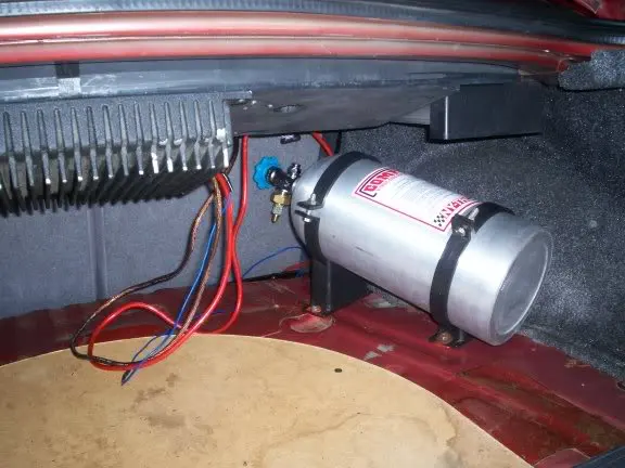

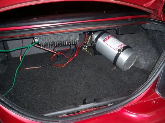

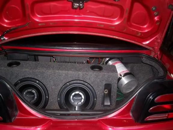

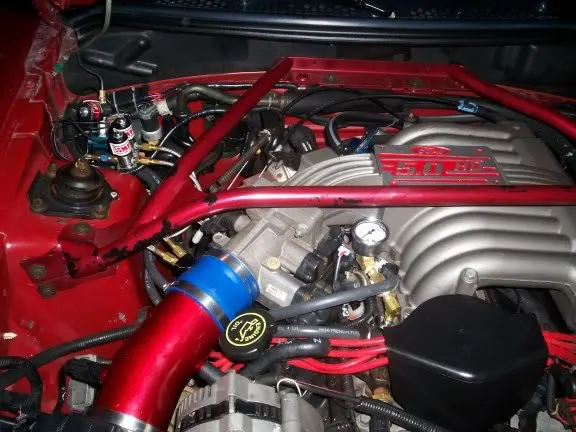

heres some pics of the compucar wet kit i'm installing all the hardware is installed i'm waiting on my msd rpm switch to wire system...
just getting started
first i installed the solenoids,gas line and nozzle
then i installed the purge line
then i mounted the bottle
ran the nitrous line and reinstalled carpet

NICE..not to be overy personal but what would you say the total investment is 'complete' on the system your currently running. I have been looking at the Zex system with purge/warmer/auto valve open...though not yet priced complete, I'd love to have something to compare it too.
compucar wet kit $335
msd rpm activated window switch $79.90
msd 3000 & 5000 series modules $53.00
bottle heater (thanks roland69) $51.00
bottle heater cut off switch $43.00
total $563
i also added an adjustable fuel pressure regulator and fuel pressure guage for $97.85 and the kit i bought off e-bay is a compucar system i bought this system because they have a lifetime warranty even if i bought it used according to there techs the warranty is still in effect. and the kit i bought came with a bottle pressure guage,purge kit and extra solenoid these items usually have to be purchased seperately...and i'm going to run the 90 hrse. pwr. jets...
