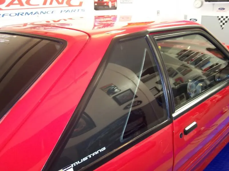

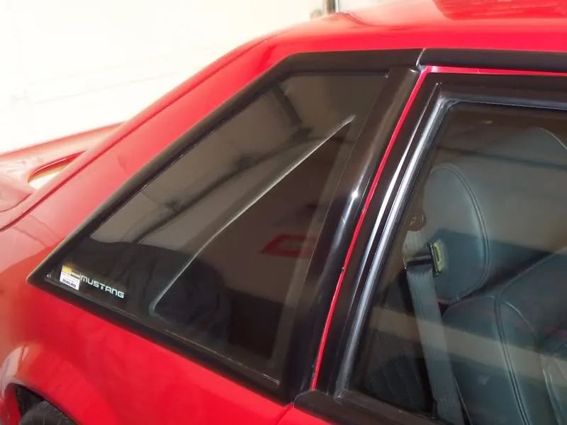

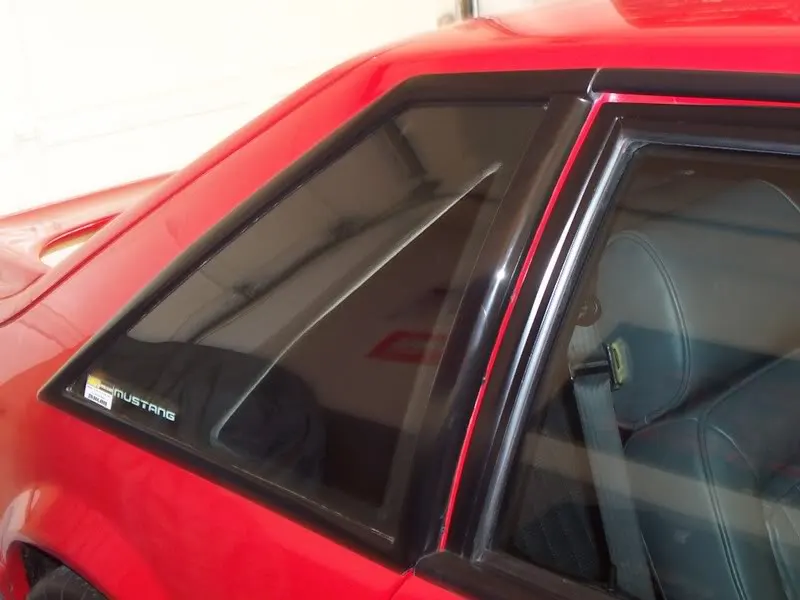

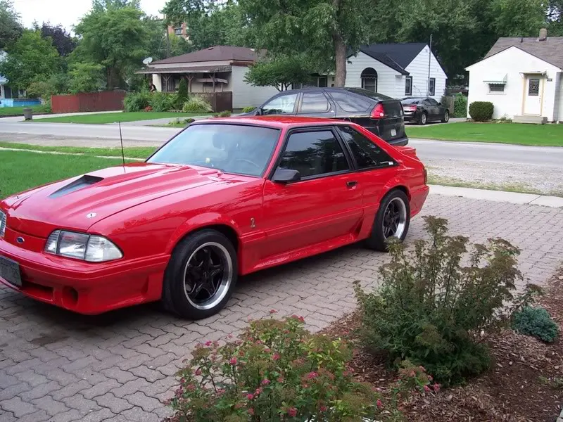

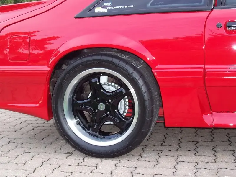

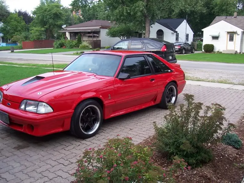

Had a memeber PM me about these recently so I have a few pics I put up for him

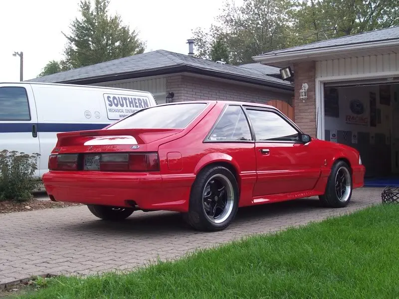

I did use them and the response from every single person who sees them is.....nothing, no one person has noticed to date and that's EXACTLY what I wanted. I have had some excellent comments regarding trim condition but no one has noticed they were not the factory moldings.
What needs to be done:
Find a auto body supply shop and ask for the 'best' available adhesive for plastic to plastic/metal...then throw the supplied adhesive away.
Test fit the moldings to ensure a flush and clean fit...fit them several times and find a few reference marks so when you apply the moldings you don't make a mess moving the molding into place getting adhesive all over the glass and body of the car. Place masking tape over the shown face of the new molding if you'd like to allow you to handle the molding and not get adhesive on it...use the tape to allow you safe areas to handle the molding without touching the molding surface directly. When the adhesive dries you can simply remove the masking tape from the trim and have no worries about residue on shown surface
Carefully scuff the original moldings with 120 grit paper then clean with windex several times to remove any existing wax or shine products.
Apply the molding to the car with several (10 plus) pcs of precut DUCT tape (excellent grip,easily reomved without damage to finish)to secure the molding in several locations to the body securely and firm to allow the adhesive to bite while keeping the molding tight against the body....allow the moldings to sit for 24 hours to dry before removing the tape...more if possible.
Pretty much it...NOTE once the tape is in place wipe any excess adhesive right away or you may have to get used to it being on the window glass or body for some time to come :)
Pretty much it..when done right they are a very affordable alternative to replacement when the original molding are too far gone to be refurbished...as mine were too far damaged.

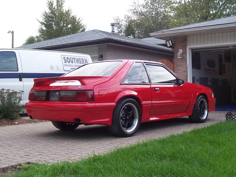

Pics: Can you tell?????

Nice dman, I cannot tell at all. Thats great and will make a great improvment for my car. Just removed all the trim, mirrors, wipers and cowling and have been painting them. Now with this, the car will look 100 x better. Thanks
I've had mine for about 3 yrs now. No one seems to really notice them. I tried urethane adhesive but it was too strong and it cracked the covers because it did not allow them to flex at all. I like the silicone adhesive black in color. It doesn't take that much really. When I first put one on, I thought they had to be like glued to the car too, but really they just need to glue to the current rubber trim.
You can check out my links for all my pictures.I got mine from Steeda, but they no longer sell them. I guess if I buy another set it will be off Ebay.

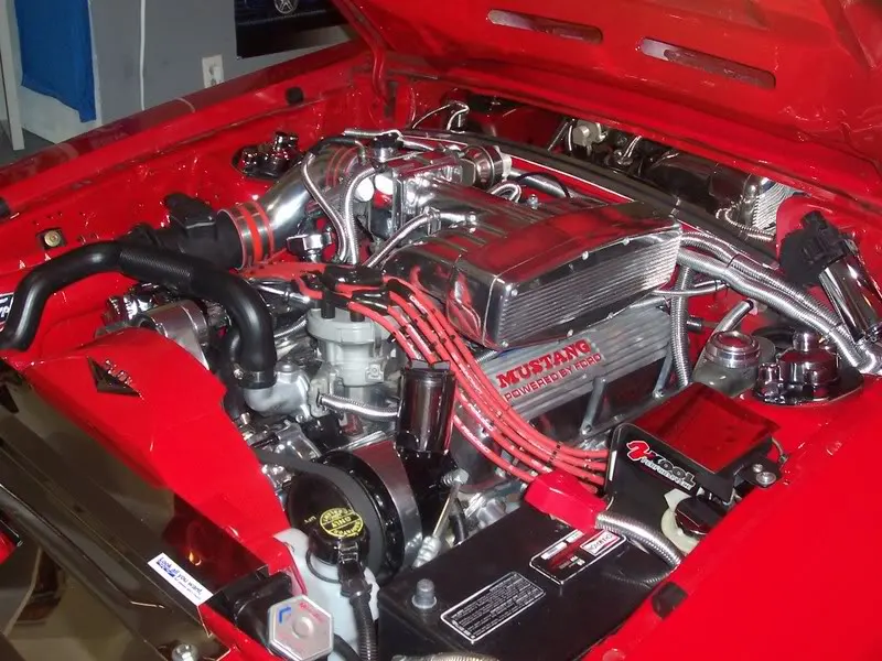

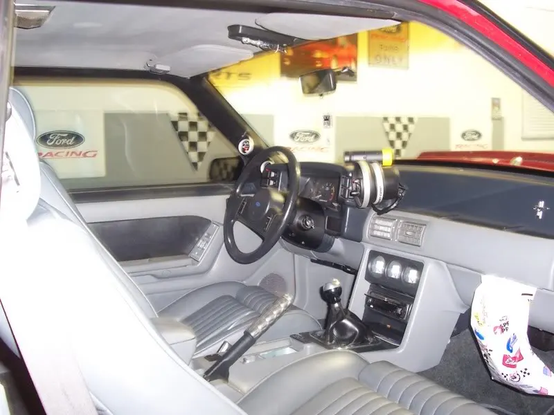

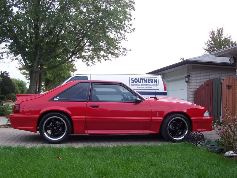

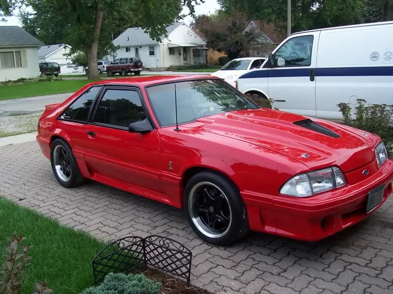

Well I gues it couldn't hurt to post a few...other than sitting in the garage looking at it this time of year, pics is all i have :(
