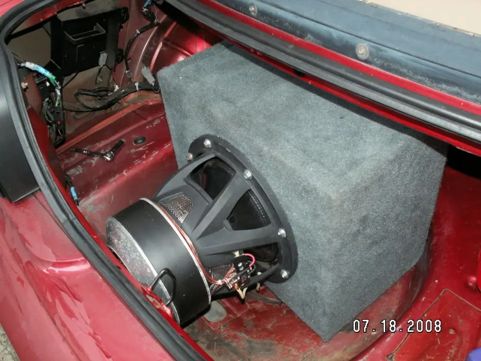

Heres My Sub...Fits Perfect Bolted in with Lag Bolts. Had to Bolt the Sub to the Box inside the trunk. Its a MTX 9500 At 1000 Watts RMS this is all i need :rolleyes:
Ill Carpet around it later.
PS Speaker in installed Inverted because MTX says the box needs to be 1-1.25 Cubic feet.....The box is about 1.25 Cubic feet...but not with the speaker driver taking up most of the space.
