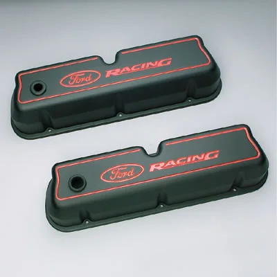

I know there's a few guys running them....let's see'em :D
These are the one's i'm talking about:
Also someone is running these with i think a Systemax intake painted to match...pics?
So us guys with EFI can only buy a certain special kind of valve covers for our 5.0's right? Lame...
Well yes and no. The issue is that those are taller than stock height to allow for roller rocker clearance, and they hit the intake manifold unless you either run an aftermarket intake or an intake spacer. A lot of aftermarket intakes rise up enough to clear the valve covers.
