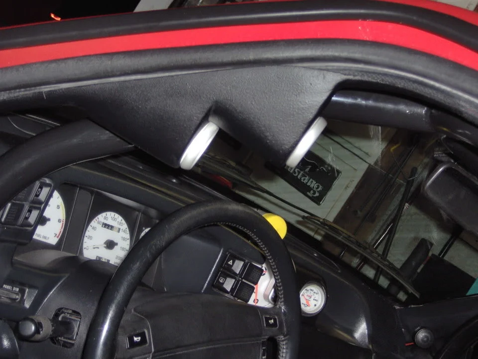

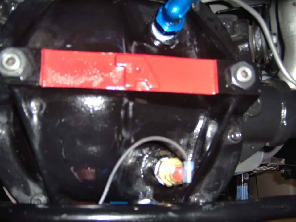

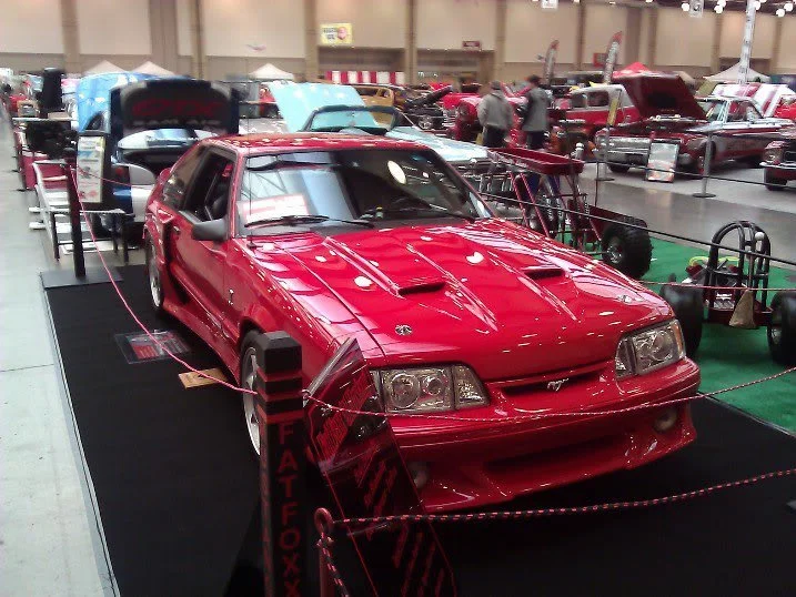

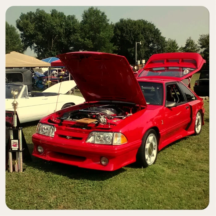

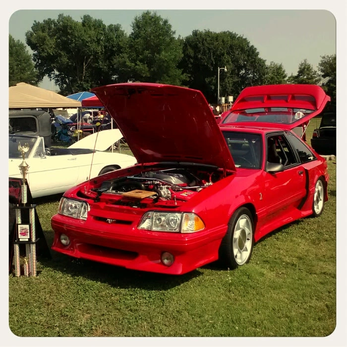

Well, excellent build but that fender stuff is not for me. The rest looks sweet though.

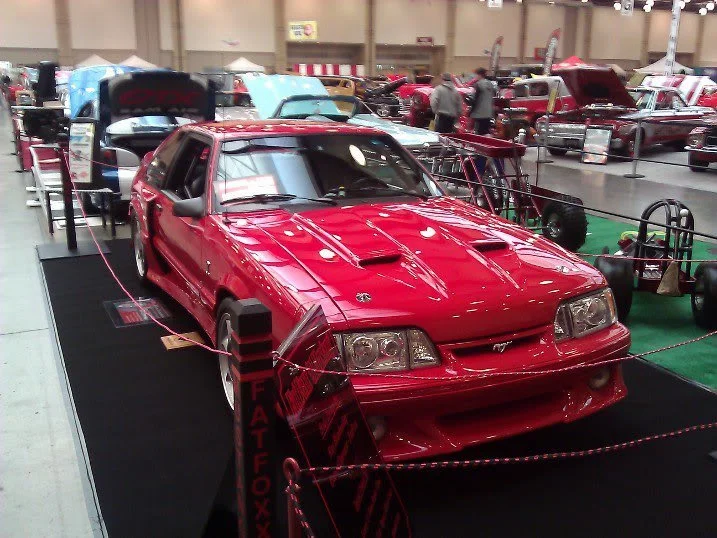

It is a autocross track car. That is the main reason I built it. The wide body kit is not for everyone. I have some people who love it and some that hate it. All in all it is what I want and have made with my own two hands. I appreciate your honesty! I like it straight no matter if it is good or bad. Keep in mind that I do drive this on the street too. But it's main purpose is to stand out from the crowd!
Yeah don't get me wrong i'm not knocking it, i would just have opted for fender flares to run wider rims/tires. Or, if you did the front fenders to match it might work better. Definitely need to see more pics from the side/back/rear 3/4.

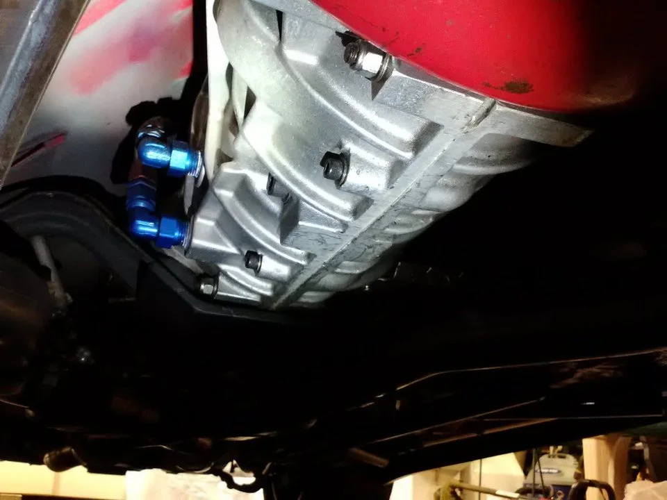

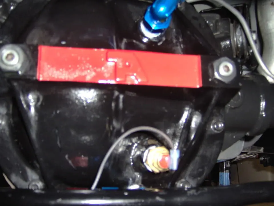

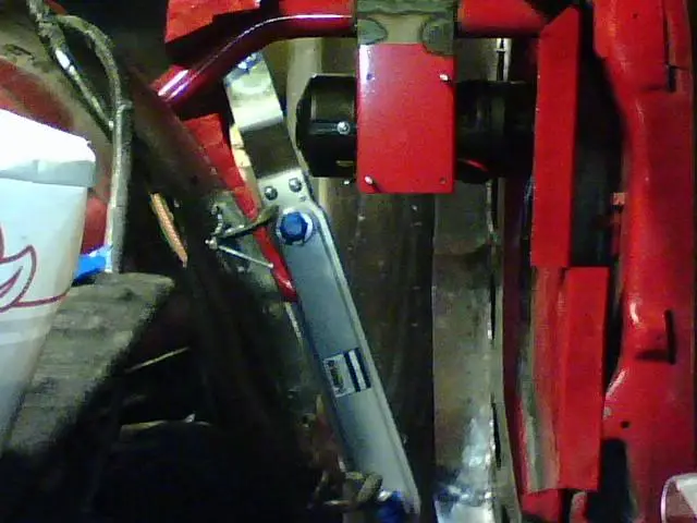

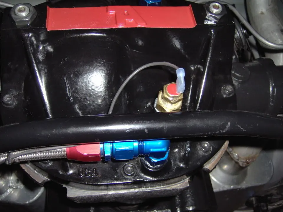

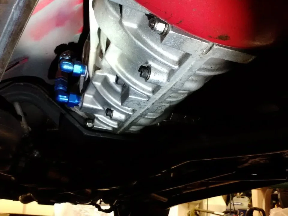

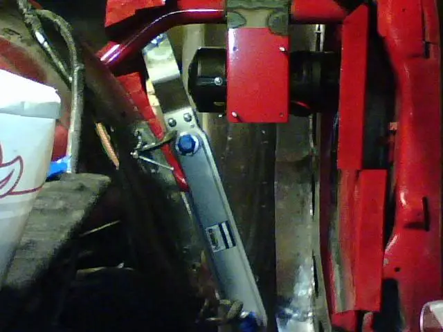

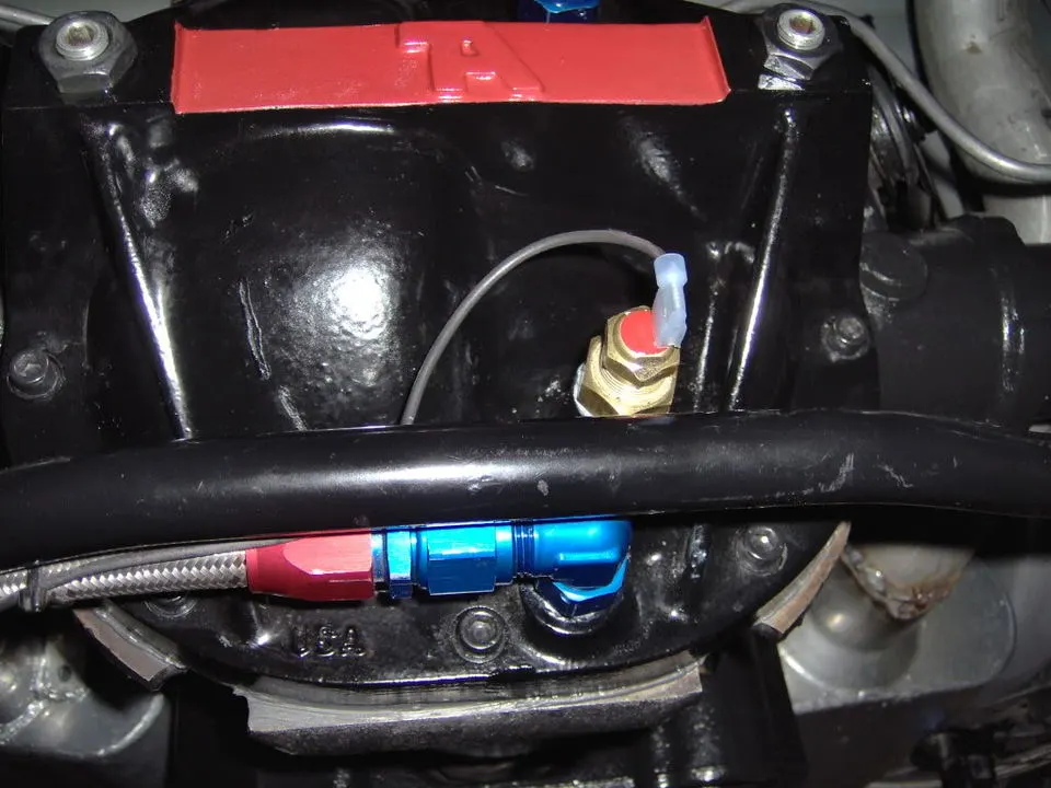

The flares I have on it are functional. I have oil coolers (in above photos) that are being cooled by the air coming into the flares. There is a k&n air filter that I modified that cleans the air so I dont get rock chips or anything that would harm the coolers. The coolers (one on driver's side and one on the passenger's side) DS cools the rear-end, the PS cools the RichmondROD 6 speed. I wanted to go this route for ultimate heat protection. If I just put the wheel arches on there I could not achive this with them.
The colour effects, like glsr or gaussian blur
Just want to see the car in natural beauty :D

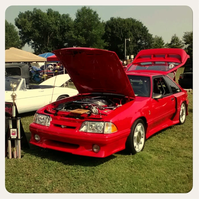

Bro what you see is what you get! I have a $12,000 paint job on this car. I really don't know what to tell you. If you seen it in person it would be the same as the pictures. There is NO photoshop on this car!!!!
No I just meant the colouring.. like the instagram stuff/old timey effect
LOL! Guys you got me going. I am not a photographer and have no idea what you guys are talking about! LOL!! I am very ignorant when it comes to these things LOL!!! You will have to educate me. I think by the way the lighting hit the car that it looks darker in some area and not in others right? My wife took this pic. She knows more about it than I do. LOL!!! I wax the car and she takes pictures of it. BAHAWAA!!!
