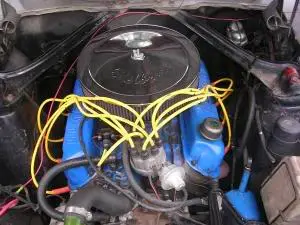

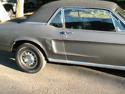

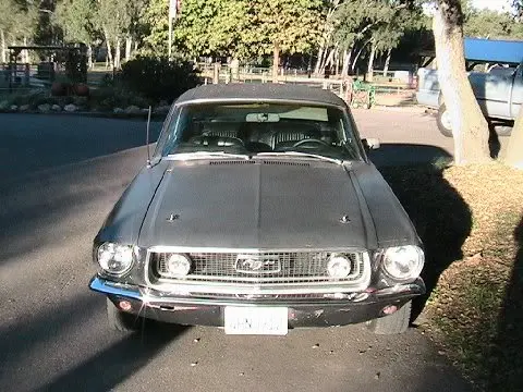

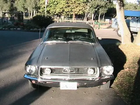

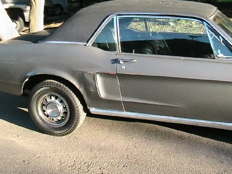

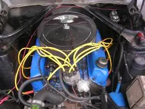

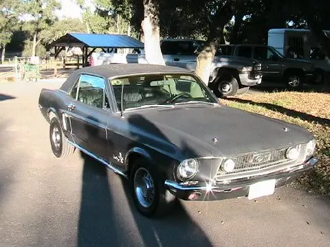

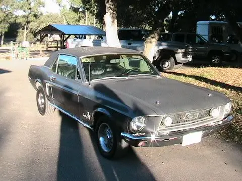

I picked this up last week. Drove it 100miles home with no problems. Ran really good besides the exhaust leak. Had to drive with the windows down. Its a 68 mustang 289. Motor was rebuild last year. Has a c4 tranny. Has dual flowmasters and headers. New 4 column raditor and new fan. Has some rust spots but nothing to bad. It had new motor and tranny mounts. The interior is less than a year old.

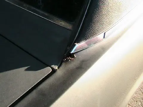

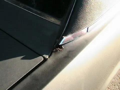

how much money do you think it will to get that back peice of rust cut out and replaced?
First im going to get the exhaust leak fixed,then new front shocks, get the rust fixed,get it painted them probably new rims and tires and some engine work.

you might want to take it to a reputable local restorer or body shop to diagnose how much rust is really there. It's hard to tell. Cowl and floor pan can be some of the most expensive to repair.

If that little spot on the C-pillar is the only rust on the car, then $3700 is a really good deal.
But like 70vert said, look it over really good for rust. Floor pans, torque boxes, toe boards, bottom corners of the fenders & doors, head light buckets, battery apron, cowl, frame rails, trunk floor & drop offs, rocker panels . . . all really bad rust spots for these older mustangs.
