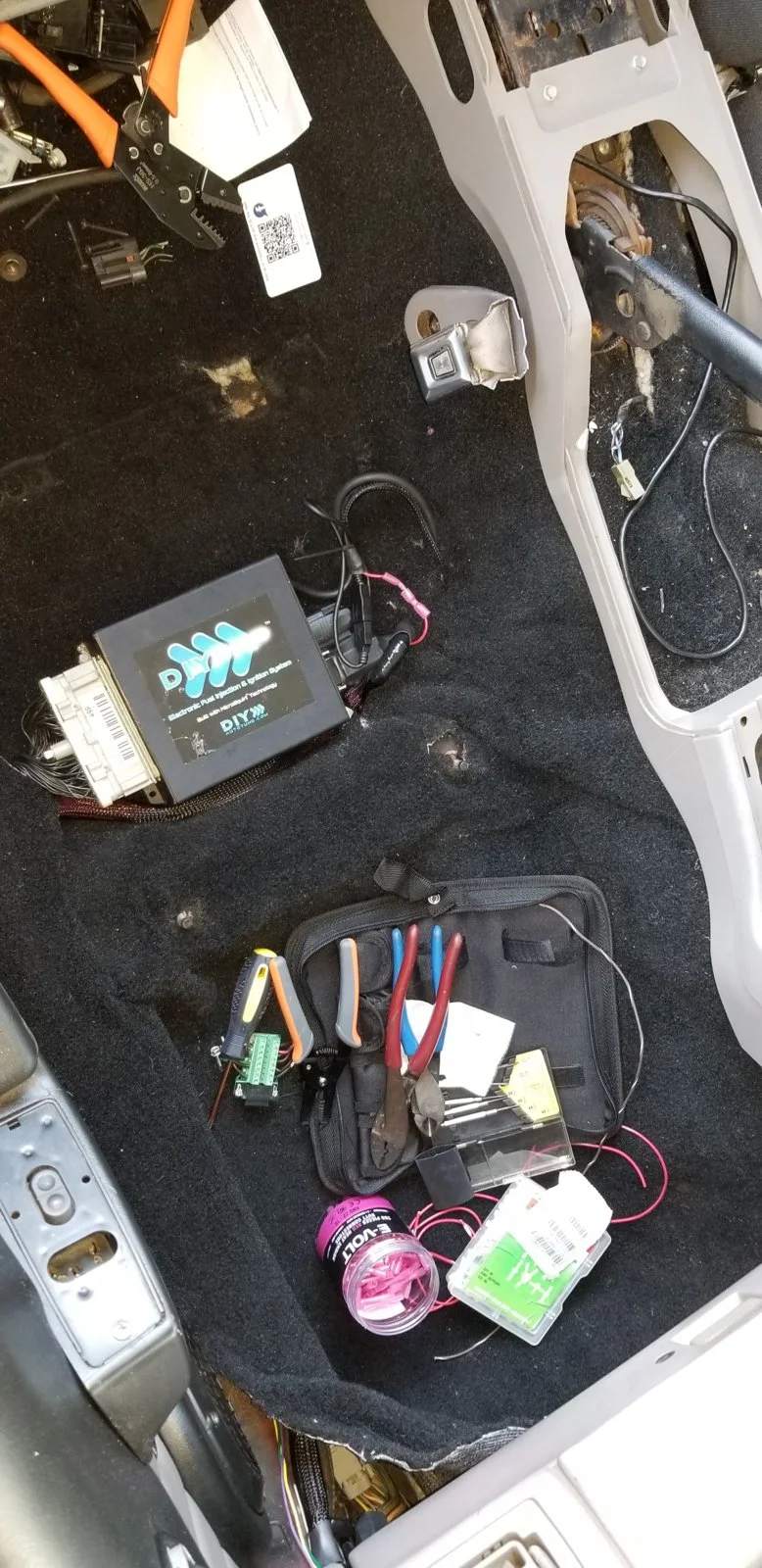

SO I bought the MS3 kit and the expansion card. I preferred the DIY since I enjoy that sort of stuff. I did claim steve's extra Rotunda cable, but I am not sure about the interface into the MS3 yet. Do I need to buy this?
https://www.diyautotune.com/product/24-megasquirt-pigtail-ms3x-harness/
24" cable so it gives me some options as to where to put the MS as it may not fit in the stock location (or will it).
I'll probably end up starting a thread in the digital forum when I start assembling the MS in the next week or so.
the rotunda harness plugs into the factory harness, you then cut off the end that would plug into the ECU and wire that to the ms3 harness or solder it to the ms3 connector. Your choice. Wiring is easier if you cant solder, and no worries about a questionable solder joint.
