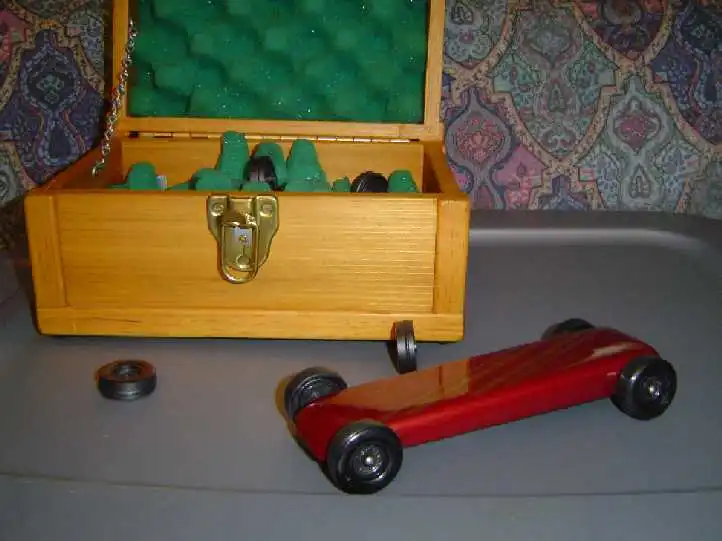

Here's my older daughter's car...Hers should win something for design at the local meet, but I built it as a speed car. I barely rolled it on the garage floor, and it went all the way across to the other side...still have to put the clearcoat on it.

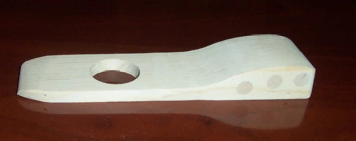

Here are the pics of the Mach...I still have to wet sand and re-gloss the top. Keep in mind that the size of the parts are larger than the car Im allowed to build, hence the disproportions in places.

1. The Mustang "may" run well, but is not really built for speed...the others are.
2. The Wheels are AWANA wheels...is that the one you need, or BSA wheels?

neat trick that I did when I was in cub scouts was to slant the nose of it from the front towards the back on the bottom side. this only works if your track uses the little rods that fold forward that start your car. when the rod folds forward, your car gets that little bit extra head start. also, if you have sources, have the axles nickle plated. I loved my dad working for the governmet. He ask when he had free time if he could work on the car a little. had the axles nickle plated, the center hollowed out and filled with lead and set in epoxy. we would get it as close as he could to the weight limit but just a little over. since everyone's scales are different, we would drill out little by little to get the weight right on the money. another trick if you can get away with it it sand and smooth the wheel surface. if you take off that outside self and make it smooth, helps you some there too.

I meant to turn it over so you can see how the underside is hollowed out to get weight off.
RFM: You can see on the Dolphin's car the front wheels are trimmed. The fronts on the lightening bolt car ave as thin as a nickel.
In terms of weight...I work with a food scale in the garage...then I take it to the post office when Im done. SInce the axles are longer than needed. I have an 8" bolt cutter that I bring with me to weighing. If the weight is over, I take out the front axles (since theyre longer than needed) and snip a little peice off :nice:
