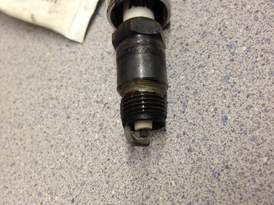

Well, I picked up a can of MAF Cleaner and cleaned my MAF, but before re-installing it I decided to pull out the #1 spark plug...

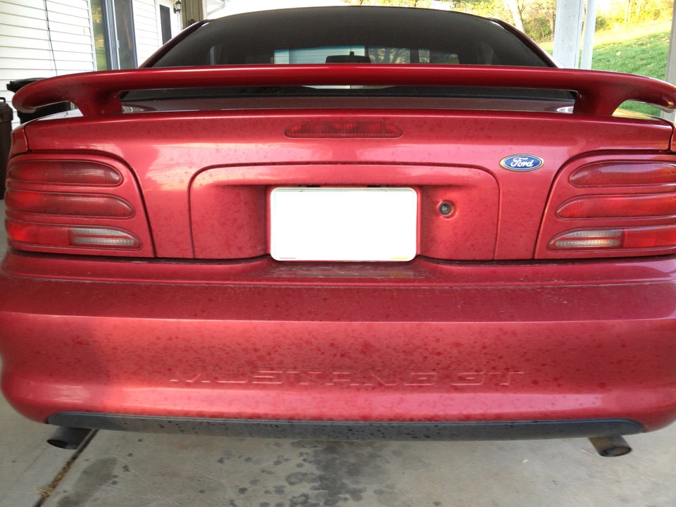

That's oil on the threads. Here's a pic of the back of my car. What I thought was gas may be oil??

Fwiw, I know I have a rear main seal leak, I just don't have time to do it right now (I bought a Bronco to drive for winter that I'm trying to get up an running). My mustang is my DD. could that somehow cause oil to up in the exhaust?
This is so strange. The oil spots are even on the plastic fuel tank cover. I don't have a way to do a compression test... and I don't really trust any dealership.
I don't mind getting into it, I just can't right now cause of my Bronco. Do you think it's a bad idea to continue to drive the Mustang this way for a few more weeks or so?
When driving fast enough, a low pressure zone is made behind a car. Any car, not just a Mustang. It will scoop up air from under the car and swirl it around the back of the car. Vans or trucks with a larger back end will have the problem more so than a Miata, for example.
I have a friend of mine who had a transmisison leak in the transmission of a van he once owned. The tranny fluid would vaporize when driving on the freeway and the low pressure would suck up the vapor droplets and cover the back of the van in tranny fluid. If your rear mail seal is leaking oil bad enough, it's possible the oil on the bumper is actually coming from the rear main seal leak. If the bottom of the car and tranny are covered in a film of motor oil, that's likely your problem.
