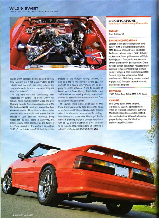

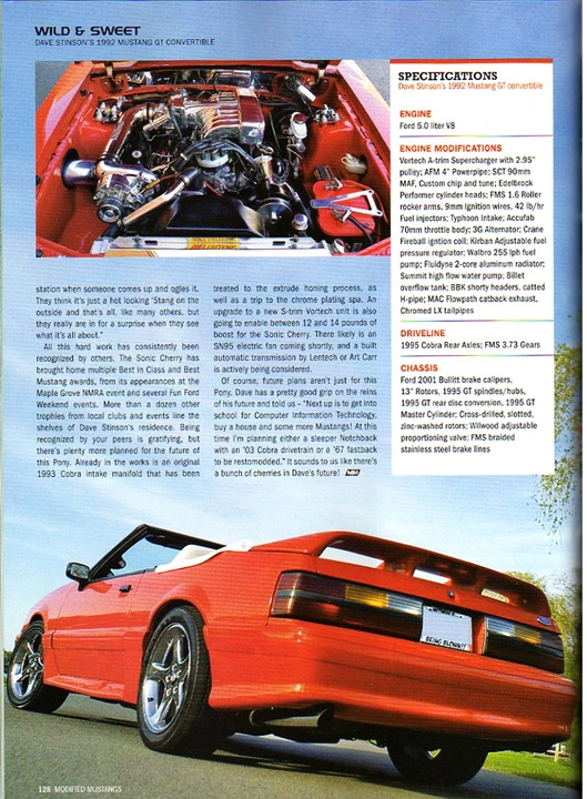

I did 'em to mine, as I preferred it over the actual OEM Cobras. The lines were pretty translucent and at times looked too light for my tastes.
The best way to do it (that I found - and I made about 2 dozen sets for people and they all loved 'em) is by counting those little squares you see in the lights. Think of separating them into two sections: upper and lower. The plastic stripe in the middle will separate the two, obviously.
In the upper section, count the number of squares from the top of the plastic strip to the top of the colored lens. Lay the 1/8" pinstripe in the very middle, and that will become your middle stripe. To find where to lay the top & bottom stripe on the top section of the lens, do the same thing. Just count the little squares (I think at this point you'll be counting by halves, but it's still easy and you can almost eye it at this point) and lay the stripes.
To do the lower section, it's the same way. Count the squares, lay pinstriping in the middle, then count up from that stripe to the top (or bottom) of the lens section and lay another in between the two.
One note, though. On the middle stripe on the bottom section, you have to cut it short before it reaches the end of the lens. I can't remember the distance but I believe it's somewhere between 2-3".
Here's the best picture of my car that I could find, that shows the lens striping. You can see how the lower middle (2nd from bottom) stripe is cut short so it doesn't extend all the way to the edge of the lens:

The real Cobras aren't centered at all...and the middle bar on the bottom row isn't whole. It stops at the side reflector
Personally, nobody on the road is gonna know if they are real or fake so what does it matter? The easiest way is to run a 1/8" pinstripe down the center of each section, and then run another pinstripe above and below it centered. That way they are all equally spaced and look even.

wow i never knew that....does it continue any on the other side of the reflector?.....i mean is it like a "break" in the stripe, or does it completely stop?...just curious lol
iwashmycar: I said that the other day in my post above. I posted a pic too. Take a look. It's faint but you can make it out.
The middle line starts at the edge of the tail lense, near where the license plate is, and then wraps around the corner (the bend in the lense) and then stops. That's the only difference between that stripe and the others.
