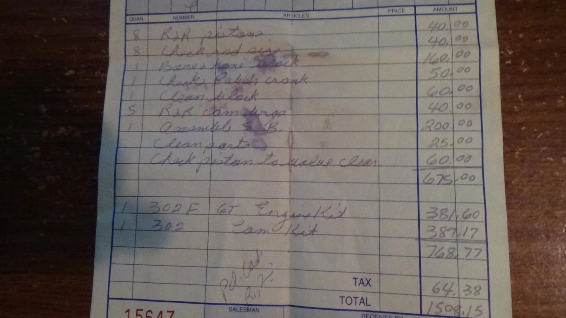

I found the old ticket from my 306 rebild. It looked like the machine work was only $675... He kind of got me on the camshaft kit, but I ended up reusing it on a stock rebuild later. I dont know if this helps at all? It came with a full gasket set also.
