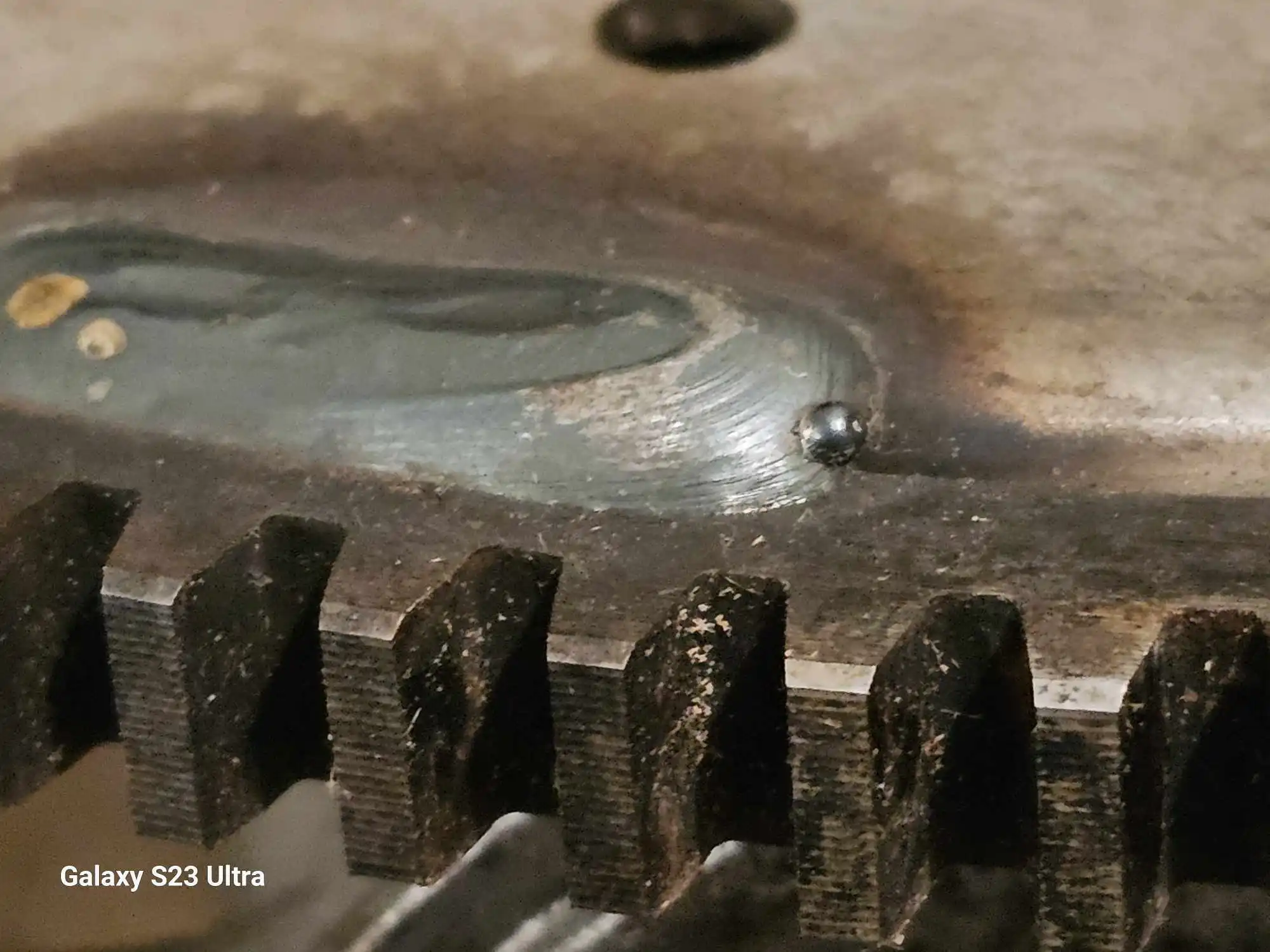

Well, I had to get that off my chest. I'm REALLY tired of starter issues in my II. lol Back when I had the stock starter, never had issues, but when I built the stroker engine, and had to run a full size oil pan to clear the stud girdle, everything went to hell with the starter. The stock piece would no longer fit, so I turned to a Mcleod mini starter, which ended up tearing the teeth off 2 flexplates. Then I went with a OEM 1995-ish GT small starter, it proceeded to tear up a flexplate. So now, I'm working on the II again, and have the trans out to get freshened up by Dynamic Racing, and yet another flexplate ready to install. But this time, I'm taking careful measurements of everything. First thing, this new mexico-made flexplate looks decent, until you closely examine it. Where they tacked the ring gear to the plate, there is welding beads stuck to it, and there was a large bead stuck right to the damn gear tooth, and a smaller bead stuck to another gear tooth. Damn I'm glad I checked it. Always examine your new parts carefully. I used my jewelry lens and a tiny file to remove all traces of the offending weld bead. That would've been ugly had I not spotted it, the first time I hit the starter. In the attached pics, there is a prominent weld bead stuck to the plate, harmless enough, but the one on the tooth wasn't so benign. In the 2nd pic, upper portion of the tooth, you can see where the bead has been filed off. It wasn't small, nor was it easily removed. It had tack welded itself firmly in place on that tooth. (Always check for this! you do not want the starter grinding over a weld beady, similar to a BB in a gear set)
Now to my 2nd issue. Figuring out exactly what size this mex-flex really is, in relation to the oem Ford-flex. The aftermarket piece is 11.906" diameter of the ring gear. The listing shows it should be 11.975", which, if true, would mean there is extra clearance between the starter pinion and ring gear teeth, not a good thing. Does anyone have an EXACT measurement of the OEM flexplate diameter? I'm very curious if that is causing issues in itself.
The next issue... The old torn up flexplate has marks showing the starter pinion only engaged about 70% of the ring gear teeth, not good. It also reveals that the mesh isn't very tight either, with wear marks only about 50% up the ring gear teeth. An indicator that there might be too much clearance between the pinion and ring gear. I want this thing to be perfect, and I know it's possible with some care. Anyone have input on related issues with starter/flexplate meshing properly/improperly due to aftermarket cra.. er, stuff? I would appreciate any opinions.

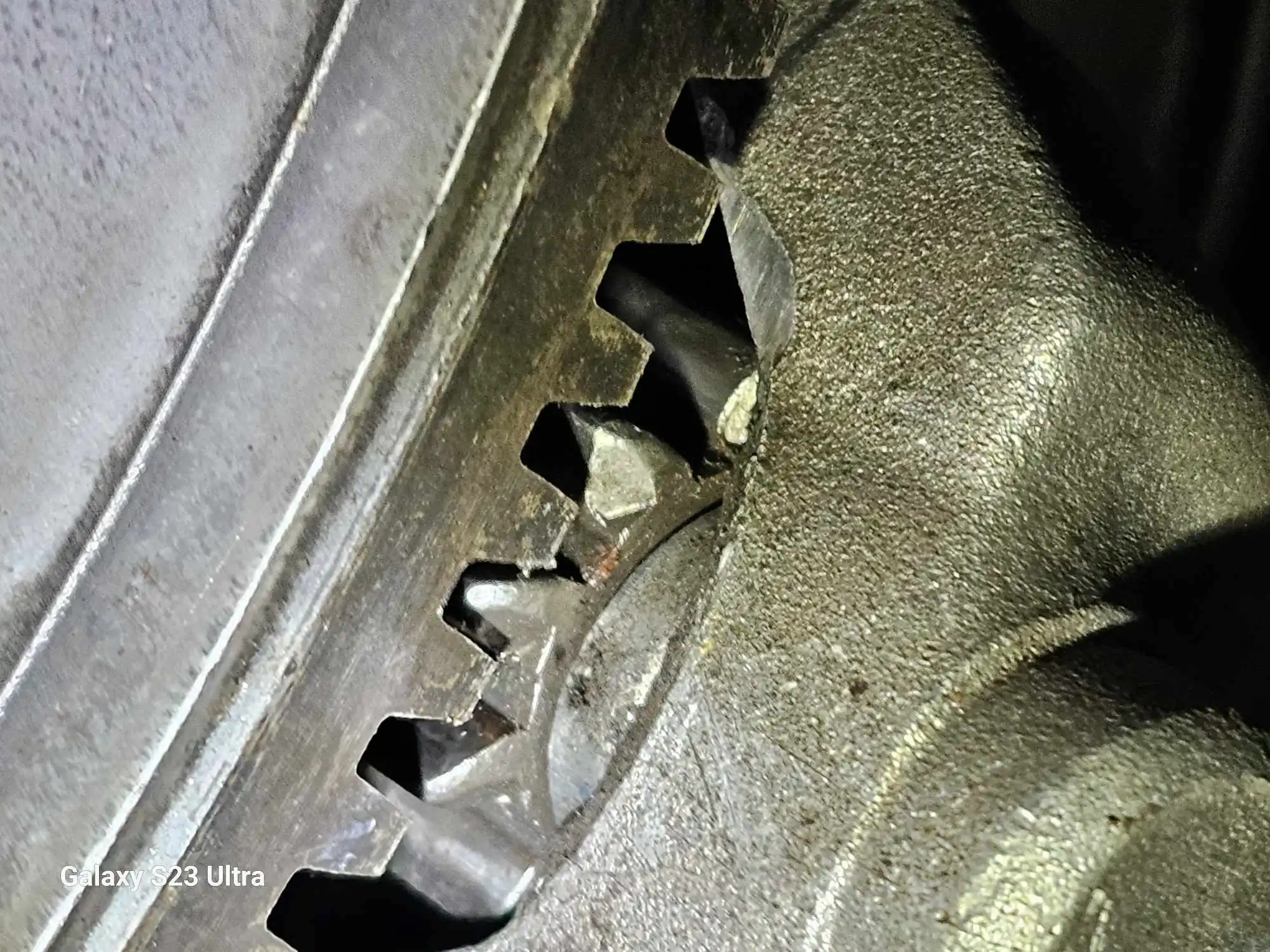

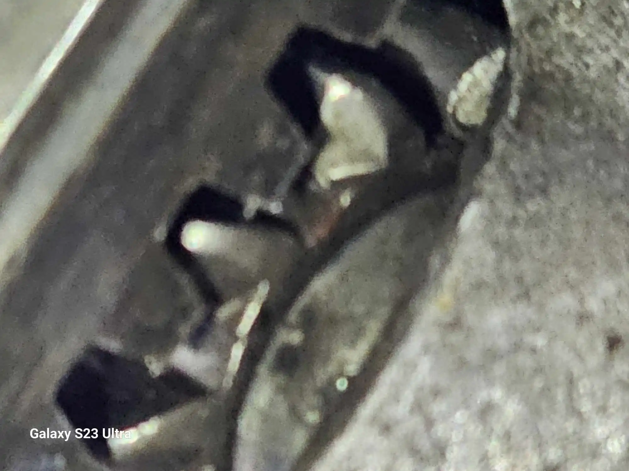

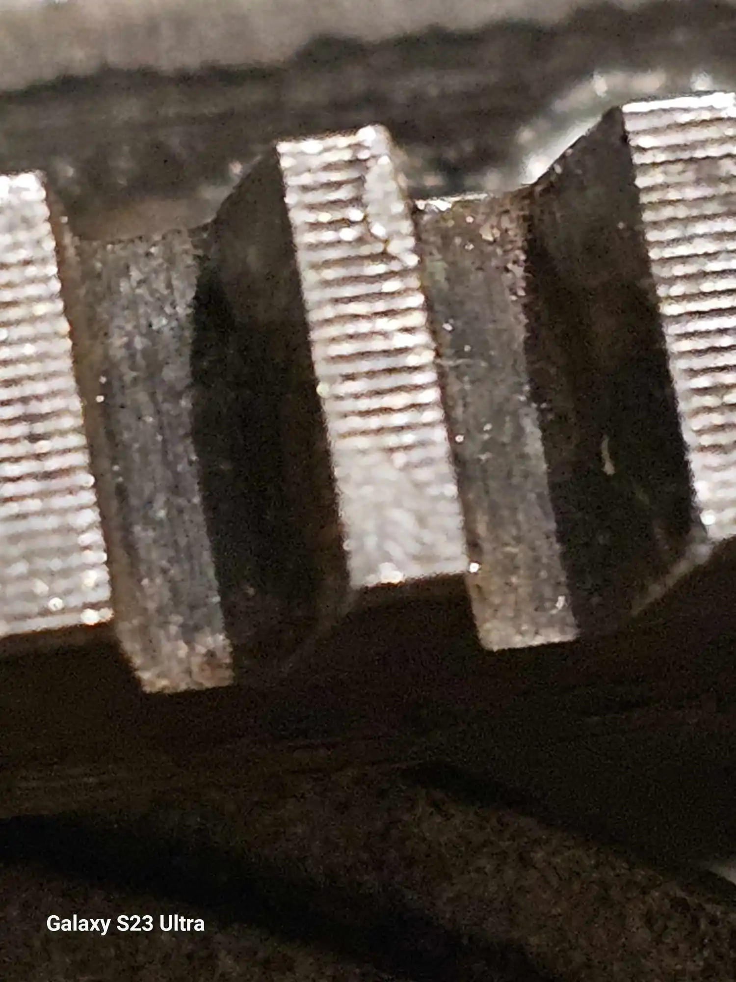

I think I figured something out with the starter today. While the C4 is out of the car, I used my spare V8 bellhousing, bolted it temporarily to the engine with the new flexplate, and I took the solenoid off the starter, and taped the bendix so it was in the full engaged position. I then crawled under the car with a light and my phone to peer inside the bellhousing opening to see exactly wth is going on with the starter. As I expected, the starter teeth aren't engaging far enough. I wonder if my eagle 4340 forged crankshaft has a thicker flexplate flange on it, than the OEM iron crankshaft has. It would explain the greater flexplate depth. I need the starter to go about 1/8" further into the bellhousing. The flange of the starter is thin, so I can't just have someone mill off .125" from the mating surface, otherwise, that would be an easy fix. I'd have to weld up the stupid aluminum starter flange first, then have it milled. ugh.

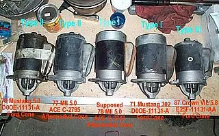

That didn't take long..... You can check out the thread links in one of my old posts, maybe that can help shed some light for you. :cross:
You've brought up an aspect that I don't think has been explored in a long time - at least I don't remember it being mentioned anywhere. I did some more searching and found a couple threads that might be relevant.
In this thread, Gael mentioned that he counted his drive teeth and found that his had 9 teeth.
Then, a couple months later, he posted this thread and said that both his starter and a new mini starter that he went with had 10 teeth.
:confused:
Another couple of threads mentioned a couple of different things. First, there was this thread talking about the different cone depths.
Then, there's this thread which states in post #6 that the automatic flexplate has 141 teeth whereas the manual's flywheel has 148 teeth. :O_o:
https://stangnet.com/mustang-forums...rters-work-with-our-smaller-flywheels.502778/
Then, there's this one that mentions the gear pitch which makes a lot of sense if you think about it.
Then, finally, we have Matt's suggestion for using a late model Fox or SN95 starter when using a larger oil pan.
Now, it seems that most of the problems people have with starters concerns using them with the automatic's flexplate. In one of those linked threads someone made mention of having a manual and being able to get a starter that would work at any time. And, in my experience, I think that's most likely true. I don't remember having any of the problems that I see mentioned all over - but then again, I've not had an automatic transmission since the mid 90s. SO - what I think I might try is Matt's suggestion and go with a Fox starter. I know they're a little smaller than the stocker and shouldn't be some outrageous price compared to an aftermarket high torque mini. Looking at this guy here:

The old gear reduction starter I ran in the 2000s, a McLeod unit, was amazingly well built, but it ground the first flexplate up rather quickly, and was even worse than the 1995 GT mini starter I replaced it with. I just measured and compared those 2 starters, and the McLeod, is in fact, even shallower than the OEM 1995 ford unit. That would explain why it was even worse. The bright side, the McLeod only has about 1000 miles on it, and the flange is definitely thick enough to mill.
I'm actually running a standard size passenger car front sump Milodon pan, as it was required to clear the billet steel stud girdle in my engine. I removed the power steering setup and replaced it with a manual pinto rack with a pinto steering rag joint.(that shed 35 lbs, too) and a mini starter is needed to clear that big pan, too, it's about 1/4" from the pan when the starter is installed. The number of teeth on the starter is correct, as the distance from the starter gear to the flexplate teeth looks correct.(the mesh, as can be checked with some white paint on the teeth, like you would on a ring and pinion in the axle) It's the depth that is the issue. If your starter is too far from the flexplate, (like mine is) the bendix throws the gear out to engage the flexplate, and since it's too far, the starter gear is already moving way too fast by that time, and it grinds like hell upon striking the flexplate teeth. On the opposite end, if the starter is too close to the flexplate, then the bendix will try to throw the starter gear out to engage the flexplate, only it's so close, that the gear hasnt even begun to spin yet, and that can cause the gear to just not engage the flexplate at all, like hitting a wall. So proper starter depth is critical.

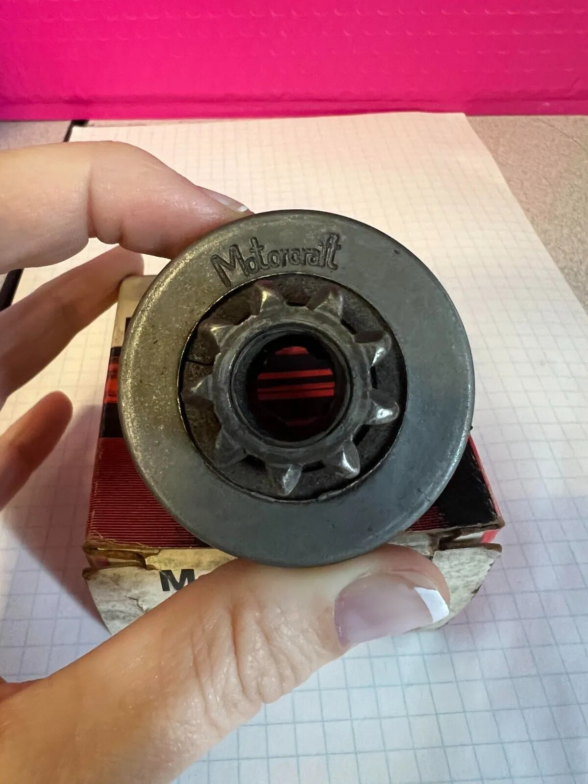

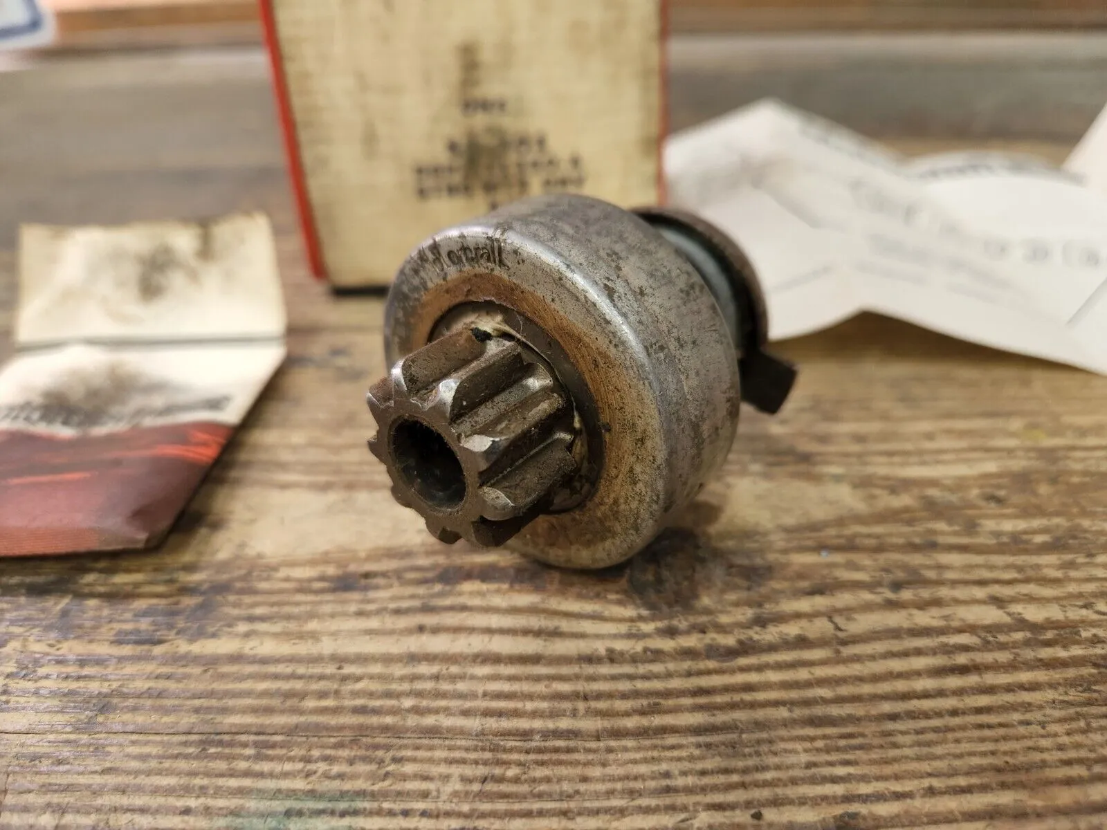

The starter drives had a few differences, tooth count and size mainly
You might try to check the specs of a few starter drives
Like the difference between a SD 302 and a SD 301 or a Ford C4TZ-11350-B
The Ford drives last quite a while
