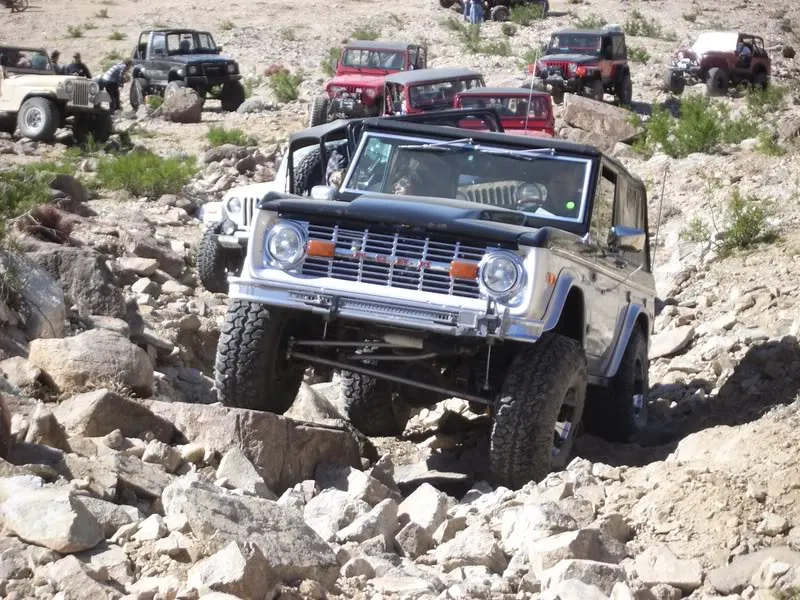

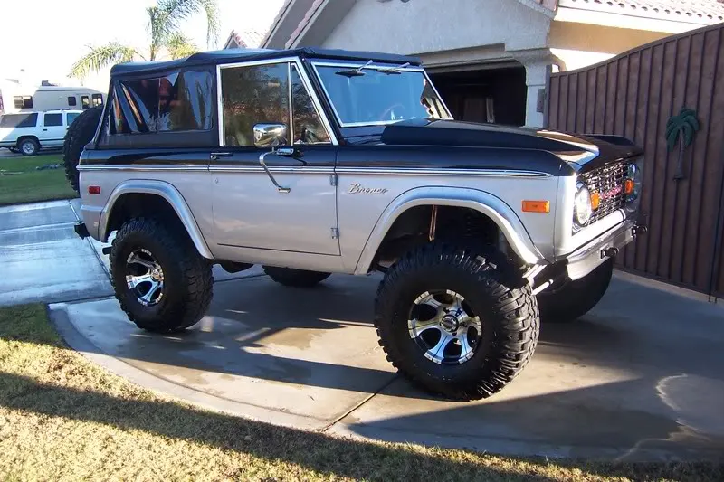

BTW nice Bronco! can you post a picture?
