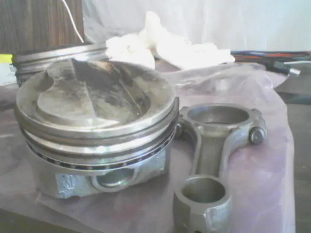

So heres the piston and my rod. For clarification I guess. Could reliefs be cut into the piston for clearance? I would be running 1.94 intake and 1.6 ex on windsors. Not sure on cam, .5-.65 lift.
As you can see the pistons have been run, and to my knowledge it was with these rods in a ford block...

I looked again back on KB's site and they list a chevy popup with a .400 dome that's part # KB801. That what you have? The pin height's about right for a Boss rod length and the dome would be closer to a Ford Windsor head. Only thing is the popup needs to be oriented correctly for the head clearance. Or have the domes milled flat.
