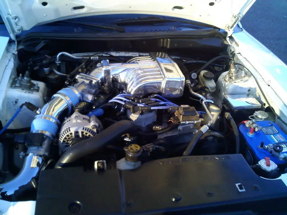

The car has 160k miles on it. It is now burning through 2 quarts of oil every 3k miles. It is time to start seriously planning the rebuild.
In the end. I want a street car / show car / getaway car.
Fast in a straight line and faster around the curves.
Plans so far:
347 (all motor)
Internals (specifics? probe?)
Custom Grind Cam (but by who?)
AFR 185 (or bigger?)
Ford Racing Valve Covers (classic fins, polished alum)
Pro Products Intake Manifold (polished, seen above)
70mm TB (fox tb swap)
30lb Injectors
MAF (which one?)
BBK Ceramic Shorty Headers
Bassani Catted X
Magnaflow Catback
FRPP 3.73 gears
10th Anniversary Cobra Brakes
Braided SS brake lines
Drilled and Slotted Rotors
Tweecer
A T56 would be awesome but are there any better choices?
I do all my own work, so I want to keep the engine bay as clean and as uncluttered as possible (also makes for a clean show car engine bay). I want to remove anything from the engine bay that I can. AC has to stay and I still need to be able to pass emissions. I am thinking about removing the ABS. What else can I remove? I plan on doing some wire hiding and hole filling on the inner fenders.
I am sure that I left out a lot o_O but any ideas so far? What do you think? :hail:

While the motor is out- hide all the wires, repaint the engine bay and install tubular K-Member.
For the 347 you can do 185's or 205's. Your engine builder can install a custom grind cam, I got one from Crane. You can do the FOX throttle body swap or just get a 70MM SN95 style. I'd get a Pro-M 80MM mass air if you can find one. For a 347 I went with a big exhaust, 1-3/4" Ceramic Long Tubes w/ 3" collector, 3" Prochamber and 3" cat back. Shorty headers are good for a 302. Sell what you got to fund a bigger exhaust. I wouldn't remove the ABS, I'd upgrade to bigger brakes.
Sounds good so far. I wouldn't remove the ABS either. That's giving up a lot of safety for a little bit of declutter. Since you already have Cobra brakes, about the best thing you can do is put a better set of brake pads on it. Probe makes some great stuff, but it's a little on the pricey side for an N/A engine. If you want good internals, then spend the extra money for a forged crank shaft. AFR 185s are a good choice.
Kurt
Thanks for all of the quick replies :SN:
I really don't want to put a bigger exhaust system than what I have (listed above). I already have enough of a problem with my exhaust being too low and getting banged up (3rd set of cats), and that is with polyurethane motor mounts which raised things a bit. Will my exhaust be enough for a strong 347?
I live in Phoenix so there is no snow or ice and very little rain. Removing the ABS will reduce clutter and weight. I feel like it is just one more unnecessary thing in my way when I am trying to work on stuff. I see lots of racers remove it. Is it really that bad of an idea to ditch the ABS?

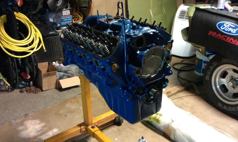

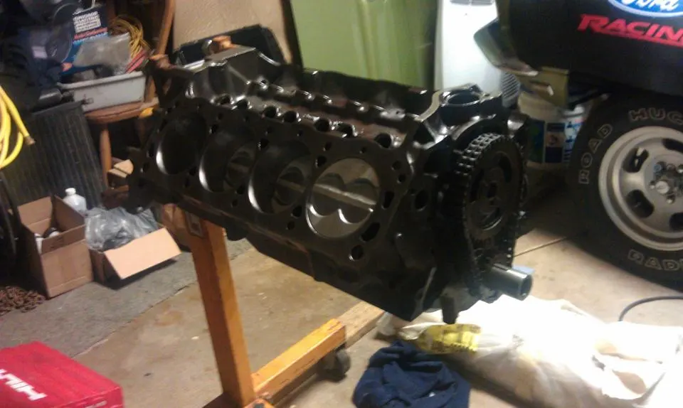

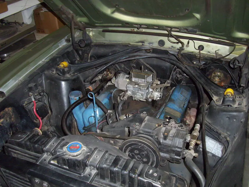

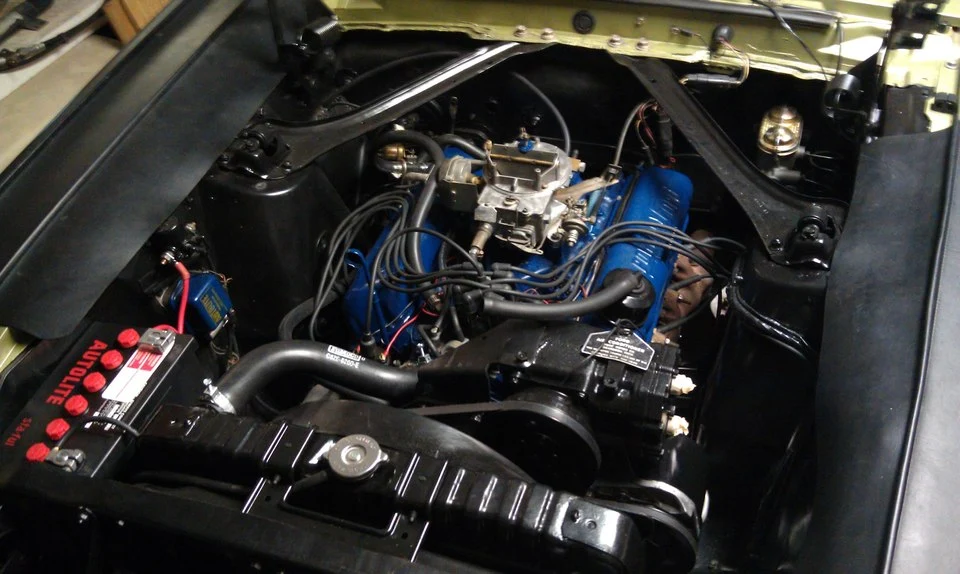

I plan on doing all of the work myself. Last summer I did my first rebuild, a 302 in our 69 Mustang. I refinished everything! Looks and runs like new :D here are some before and after pics
