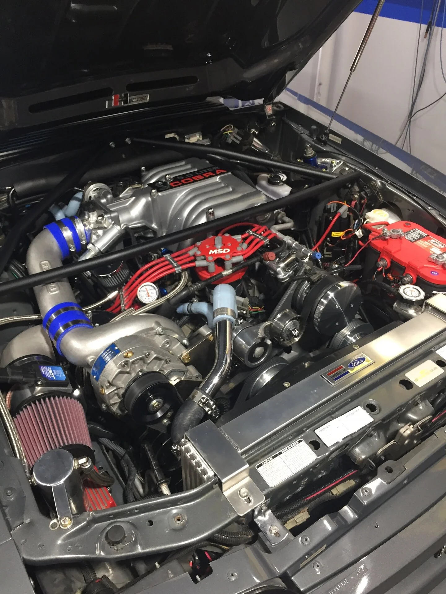

Vortech V3
Kirban FPR
255 Walbro pump
47lb Ford injectors
Air to air intercooler
Tial blow off valve
Snow water meth injection
Contour fans
MSD Blaster coil (I was having spark blowout issues)
Controlled by DIYPNP Megasquirt
Older 306 build with "B" cam and SVO GT40 aluminum heads.
Vortech V3 H.O. Kit
47lb injectors
340 lph Walbro
Stock ECU with a custom tune
Edelbrock Performer heads
Ford Racing B cam
Cobra upper intake
Stock original 5.0 block
Car made 426hp at tires, which is just at 500hp at crank. That is the number you should try to limit your build to as I hear that is about what the stock block can take.
