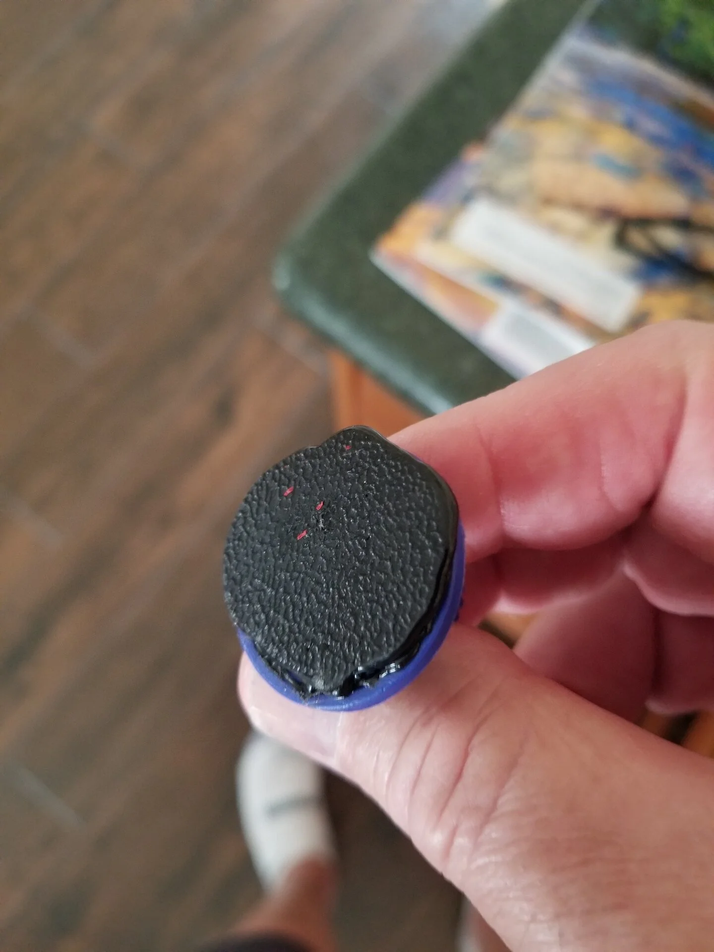

I am going to try the JB Weld for plastic. It states it works on ABS plastic.
I need to get it pretty close to so smooth at application since I am going to stamp the texture into it just before it dries.
Going by a youtube video How to copy a texture especially plastic.

Your texture stamp looks good JJHstang
Post pics of the results
