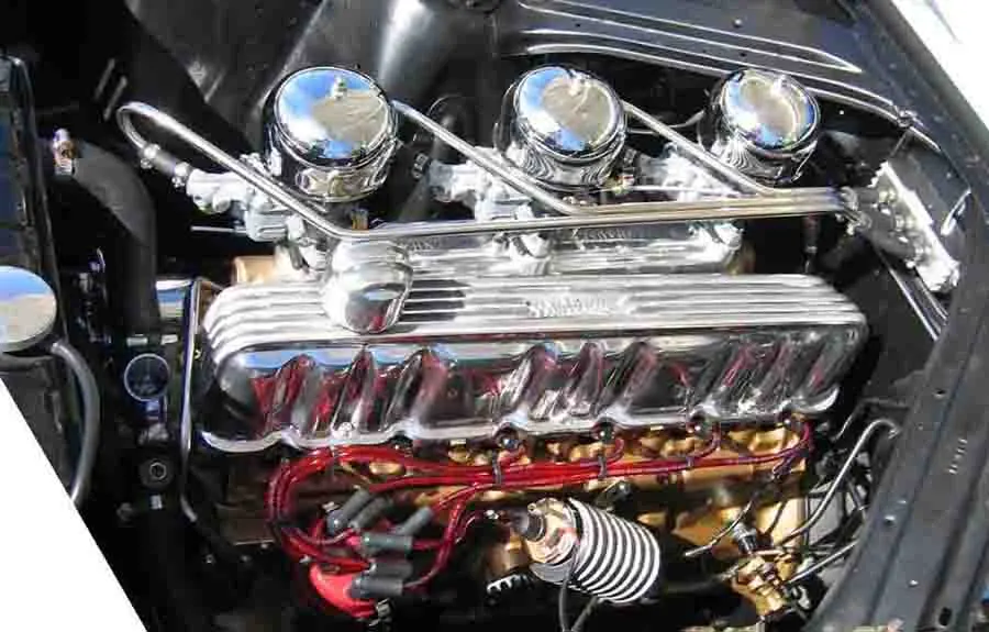

just so you know, 6cylinders don't have to be plain jane :D Now look at that and then look at a typical v8 with chrome valve covers.
