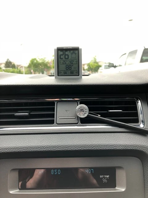

Yesterday I drove the car for 20 minutes. News station said it was 92 at the time. Car was parked in my garage out of direct sunlight. This is what I had after 20 of MAX A/C: 96 outside (always higher than actual), 88 in the car, ~50 at the vents.
The vents never seem to go below 50. When I punch the car it will warm up slightly (I assume A/C clutch disengages for engine demand) and then get cool again but never really cold.
