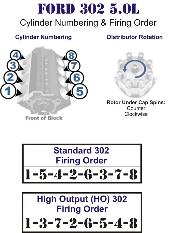

I know the firing order for an H.O 302 is different than a non-H.O 302
That being said,I don’t think it’s a big deal-and as long as you still have the complete motor for the truck. All the parts you will need to swap are there :-)

You will have to rewire the fuel injectors to match the trucks sequential firing order... If you plug the harness up on the mustang engine the injectors won't fire in the correct order because the firing order I'd different.

The only way that changes is if he put the truck camshaft in the mustang motor....or an aftermarket truck camshaft.
The injectors fire with the firing order for the truck, programmed into the truck computer. The engined firing order is determined by the camshaft ...and that is different.
You can easily re-route spark plug wires to match the firing order....not so easy with injectors.

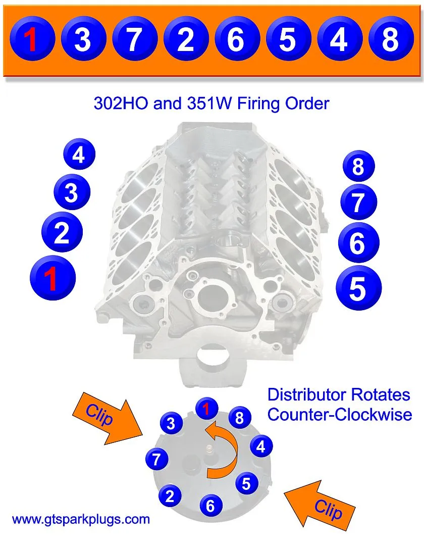

The cam does indeed determine the firing order.
In regards to the F-150, his truck should already have the 1-3-7-2-6-5-4-8 firing order. Check the underhood sticker to be sure. If that is the case, there really isn't any difference between his engine and the Mustang engine other than the aforementioned cam.
