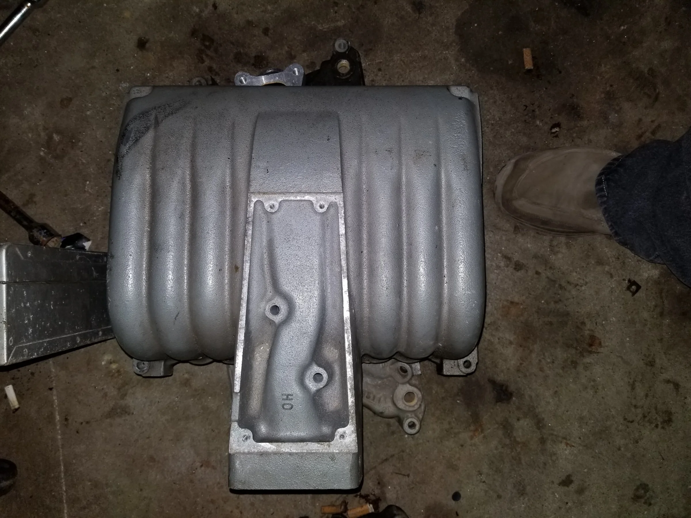

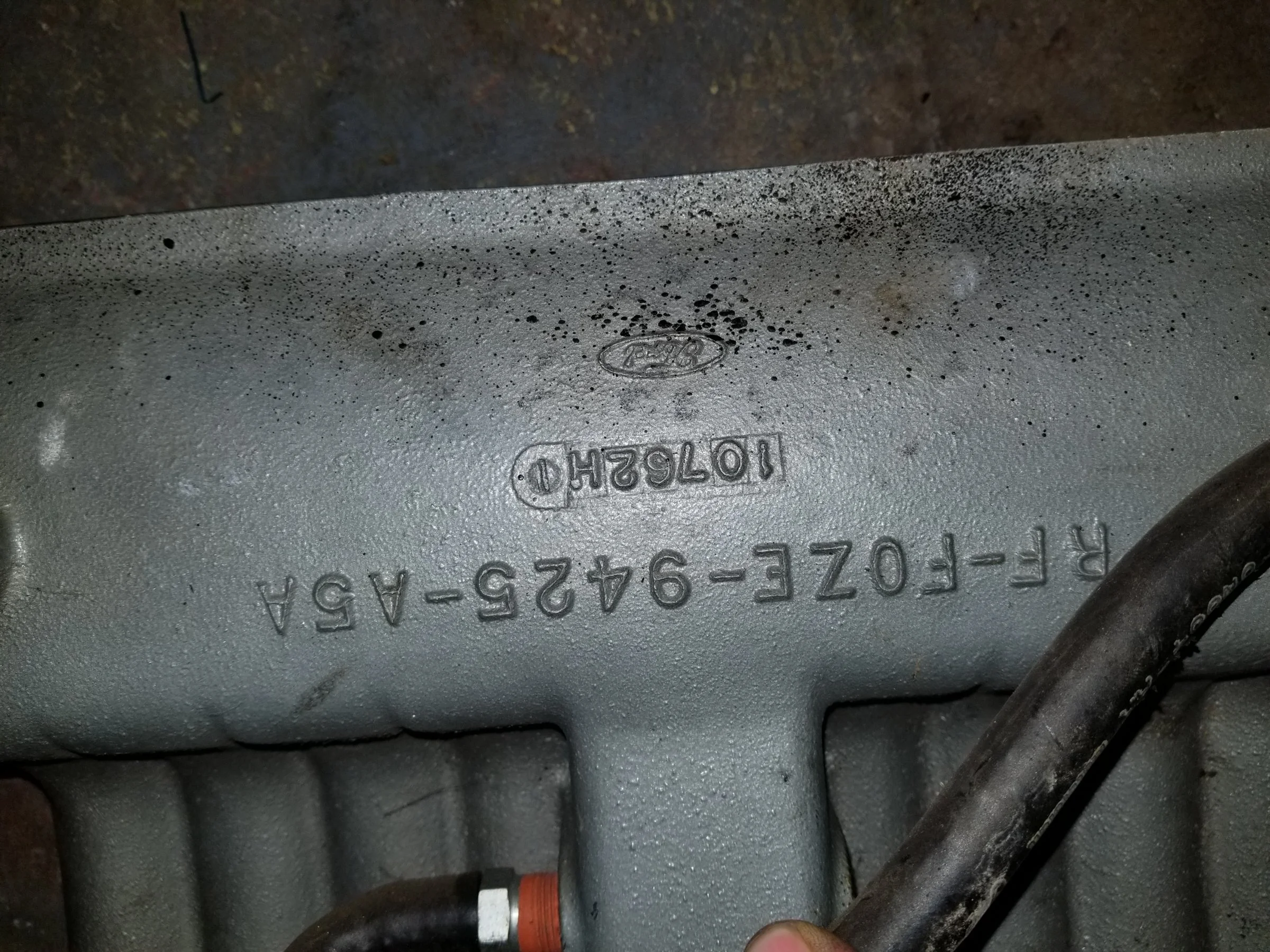

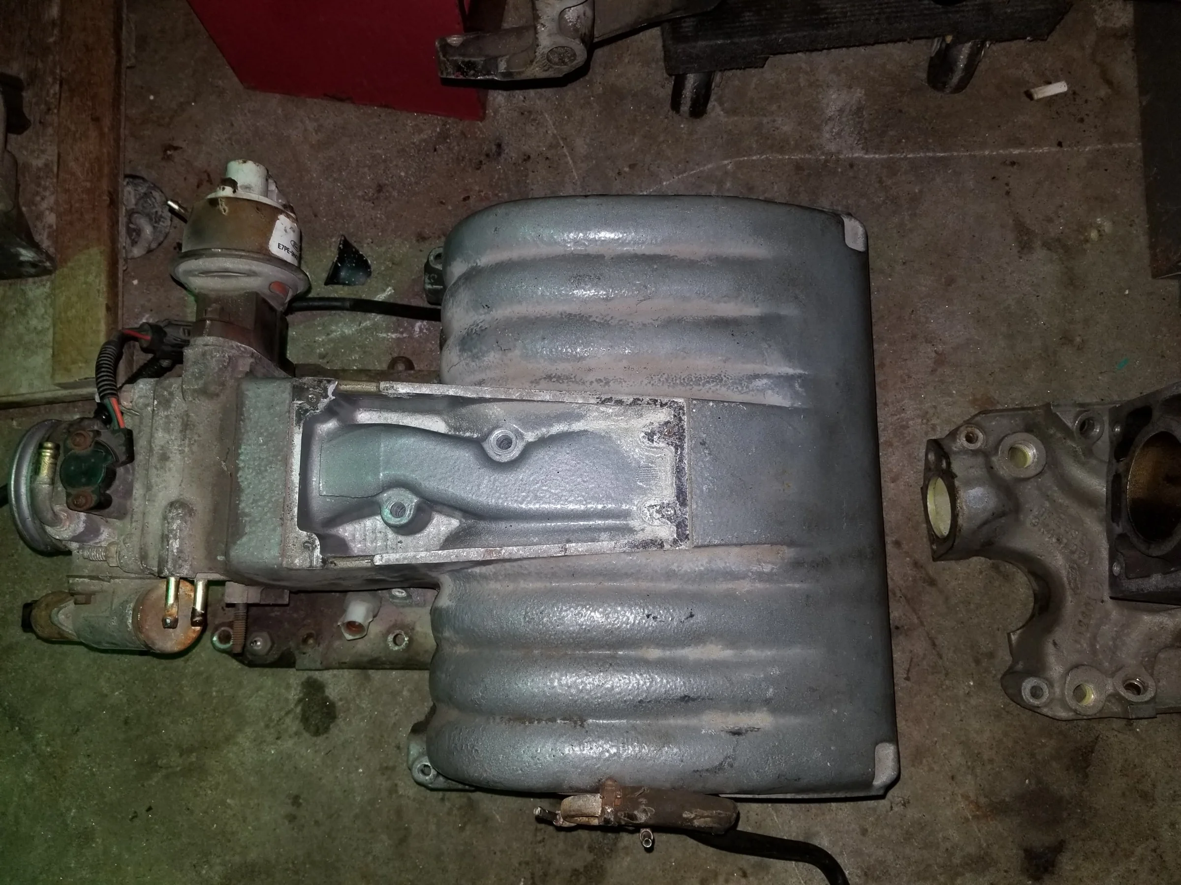

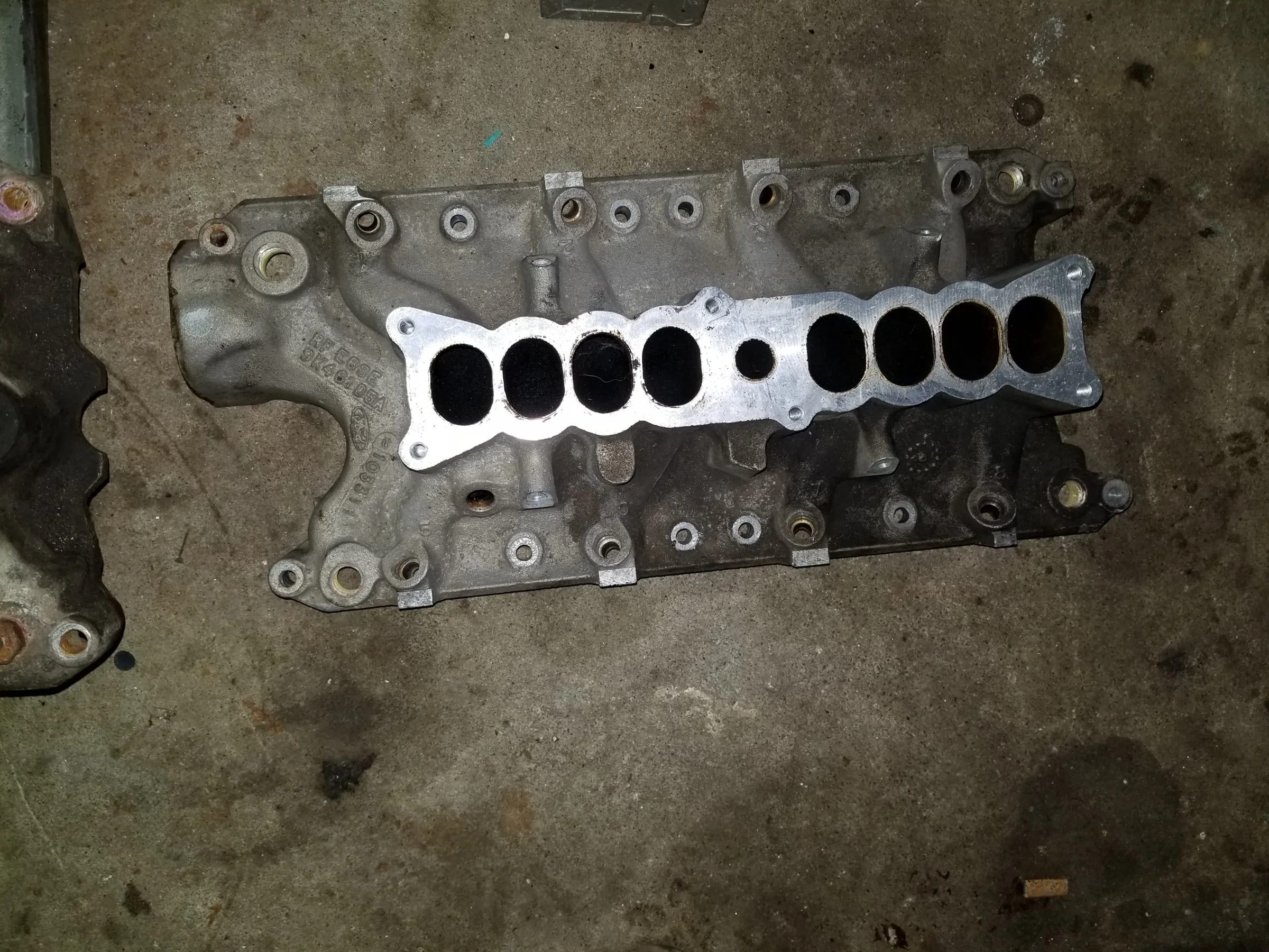

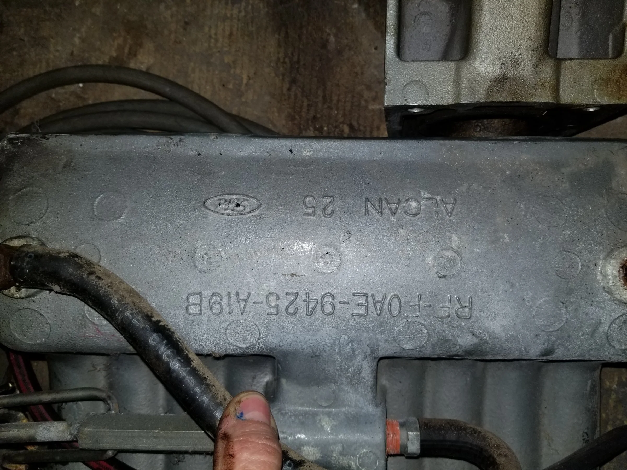

I have in this process gathered way to many parts I have some questions about intake plenum.i got two sets of upper and lower pieces. How do I tell them apart
Numbers on the bottom of the upper pieces are not the same numbers and the numbers I found. said svo but to be sure to go to another page. but of course that wouldn' open. Can you tell me how to Id It?
To post a picture its simple from a phone. When you are in the reply box there's a button on the right side that says upload file. When you touch that button it'll bring up the folders in your phone. ..like downloads or picture gallery. All you have to do is click on your photo gallery and tap the picture. When it uploads yap the button that sys " full size " it'll then show up in the typing screen. Tap post reply and the text and picture gets posted.
It took me a while to figure all this forum stuff out.....I just got rid of my trusty flip phone not all that long ago.
Its super hard to ID intakes without pictures.
Are the holes on the top of the lower intake circles, ovals, or pointed rectangles ?

Rectangular on both of the intakes and uppers and lower​
