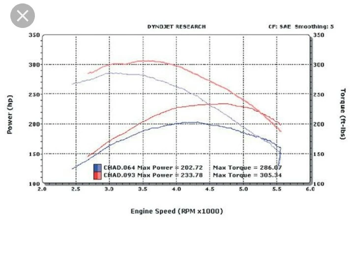

In this chart you can see what a stock mustang 5.0 made on the Dyno....look at 2400rpm mark...
There's no mention of how much wear and tear are on this engine. According to this...a mustang motor would be a dog in a truck. This debate is really hard.
If all the supporting stuff is from a truck....ie. intake, accessories, blah blah...how much would that affect the torque out come ?

I thought we wete talking sbout wether a ho motor is a good truck swap? And someone said no low end then when i called bs. Uou posted the numbers after a little name cslling. And it says right there and you said it to. That a ho makes 271 and a truck motor makes 245 at 2400 rpms. But you just cant say correct instead you want to throw a bunch of extra bs in the mix to make it complicated. The truck intake should only increase the ho torge output at 2400 so ehy go there? O ya yhats because i am correct. And yes im a little pasionate about this if you jave ever but a torque cam in and had your motor run like its a deisel im not pulling houses with a 150. Thats the only place thats needed

Here is the article I pulled that graph from.
http://www.mustangandfords.com/project-vehicles/m5lp-0701-1993-ford-mustang-bolt-on-buildup/
You may call B.S. I call it an opportunity to dig deeper to find a solid answer.
In the swaps that I've done the mustang engine felt down on power when installed in a truck...with all the truck parts.

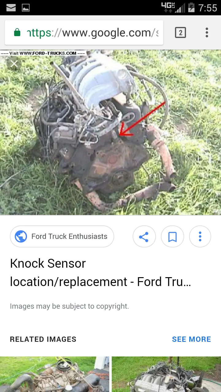

Something else to check Jesse Hayes...
Does your truck have a knock sensor ? Does the mustang engine have a place for the sensor to screw in ? Its located behind the intake screwed into a threaded hole going straight down in the block.
Some mustang blocks have the hole drilled and tapped....some don't have a hole at all.

Now thats what i was looking for. Except i didnt ask the question i just joined in. And i am about to try it. And 1157 is a lucky number and if mad mikes from michigan i got a clue who he is. But thanks i was trying to help that giy now you finakky heloed me the knock sesor was on the last one we did but i didnt realize some dont have it. Is there a answer for that?

There's an answer... The hole has to be drilled and tapped in the same spot as the truck block. I'm not sure what size thread it is...but I know its tapered pipe thread. The torque on it is pretty specific. I'd have to research to find a torque spec.
The knock sensor was a huge issue with trucks running bad...or not as good as they should. A couple years ago you couldn't buy a replacement. They do make them now though.

That 90 engine should work in the 96. No injector wire swapping or any of that. It also should have the same firing order. The only hickup is if its got that hole drilled and tapped for the knock sensor. Later in production....after 89 or 90...I believe all the blocks were the same and had the hole tapped.

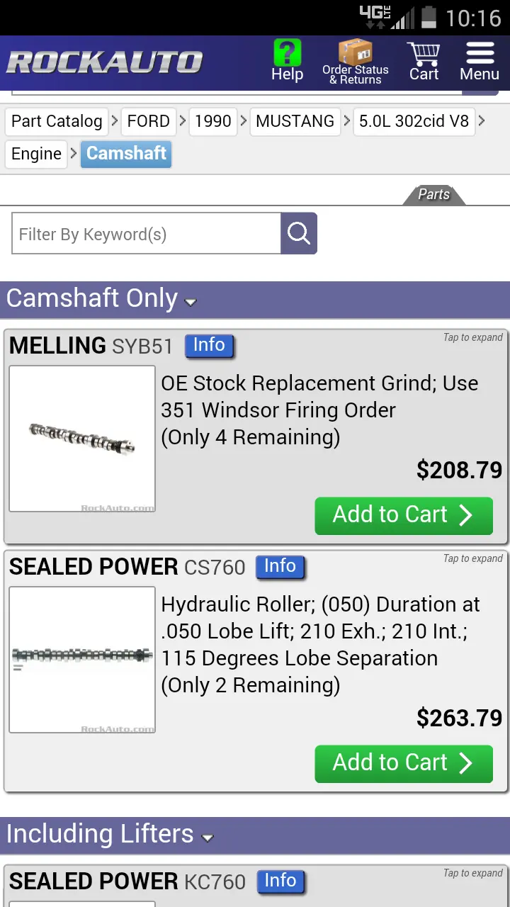

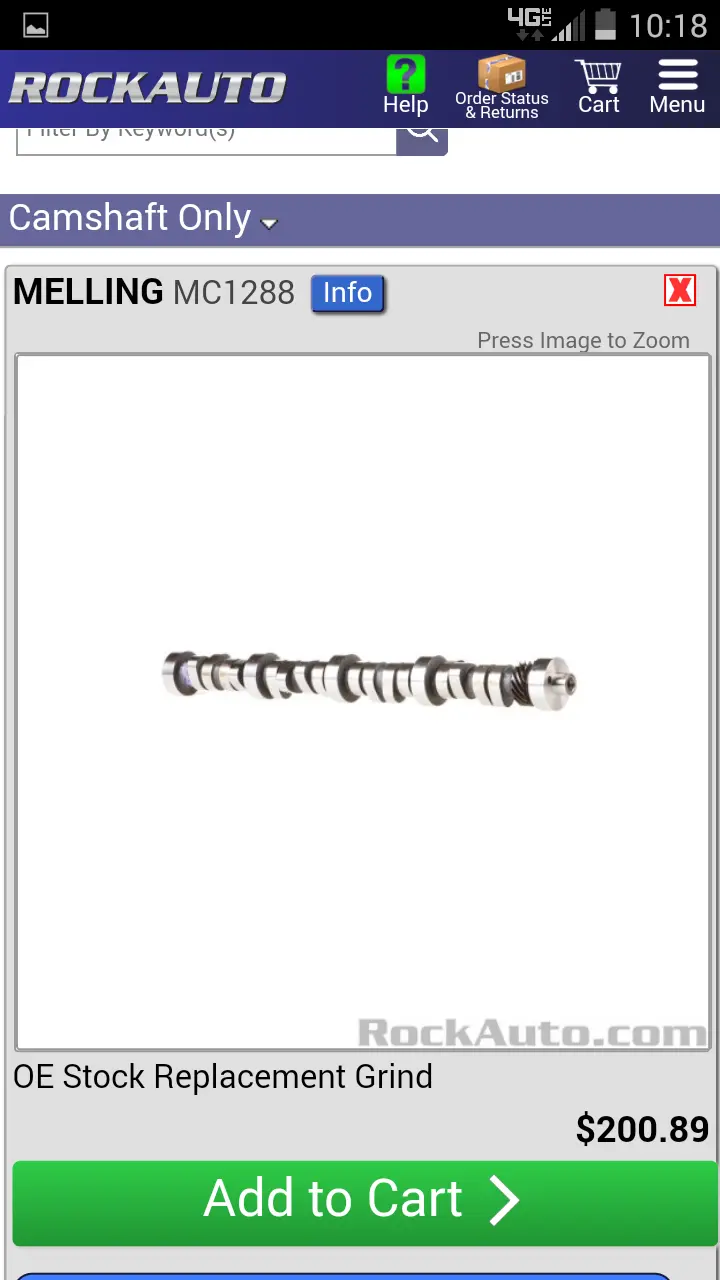

Trucks went roller and HO firing order in 95. Just found out the camshafts are different through a search at rockauto. The 1996 truck got the 351 camshaft....part number 1288...mustangs had a different camshaft but same firing order as the 351 and 95 to 96 302. That doesn't mean you can't use it. With the shift kit it may work out.
If need be...a camshaft swap isn't that hard in a truck. The easiest would be to put 1.7 roller rockers on it. It'll wake it up as bit. I used to use 1.7 rockers on the exhaust valves only. That's been Dyno tested and proven to make more power than 1.7s on intake and exhaust.

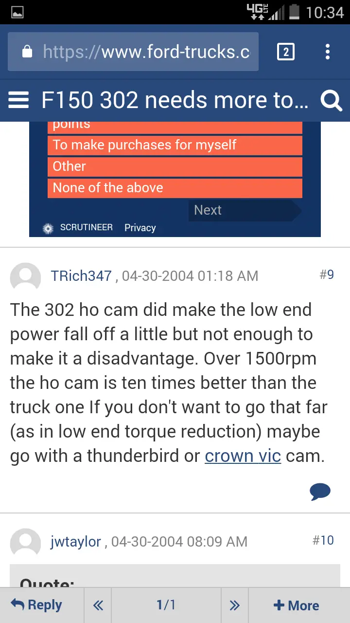

Oh I also came across this in a truck forum from others that have done this, too.
