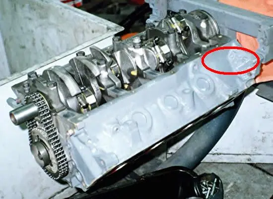

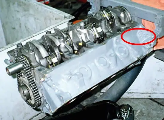

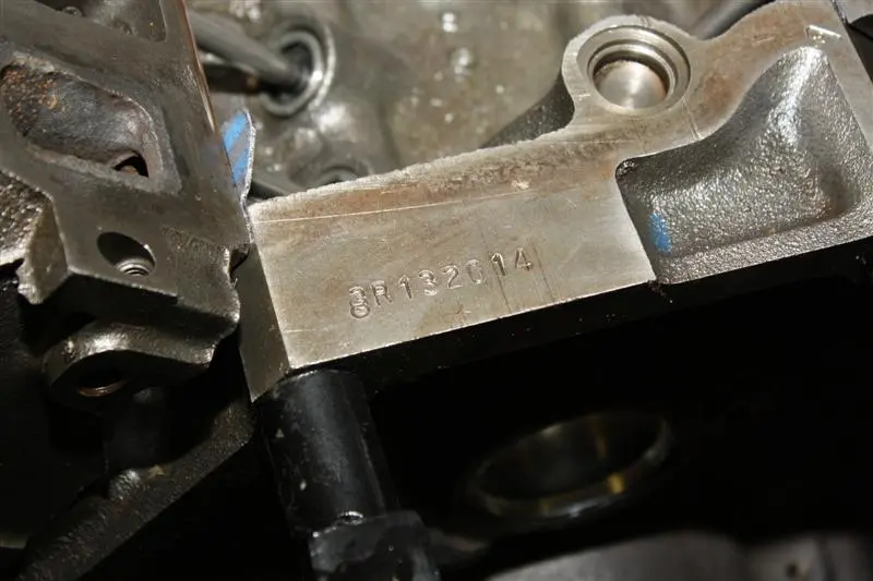

Original Block should be stamped with the cars vin behind intake or head

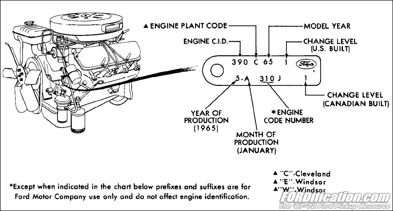

Block should have casting number by starter, and should probably be a C7OE or C8OE
Does it still have its tag?
