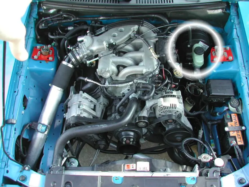

As for the brakes, 3.8s shouldn't have hydroboost brakes; all the images I can find show a typical vacuum brake booster, like so (the black cylinder behind the brake fluid reservoir):
The 4.6s are wider, and couldn't fit a vacuum booster, so the hyrdoboost system (which is much more narrow) was used.
So, the brakes and power steering aren't tied together on a V6.
Thanks tsemmet . Still learning and I misunderstood some of what I was reading. thought all the 2000's had it. Thanks for the advice. I am actually having a hard time finding what I want in or close to Ottawa, Ontario ... 95' - 2002' , Red, automatic, budget up to $2000 inc repairs to safety, seller WILLING to allow inspection .
