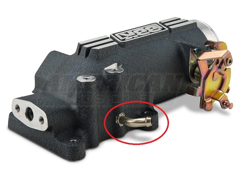

Hello all, I need to know where this hose goes to from the back of the plenum? Mine is cracked and leaves a black film on my hand when I touch it.
I also need to know the size so I can replace it tomorrow before I get on the road.
Any and all help is appreciated.

It's the vacuum port for the EVAP purge system.
Exactly how it routes through the engine bay depends upon the model year of your car.
If this is a 1996-1998 the line will pass through the purge flow sensor. Then the EVAP solenoid. And then onto charcoal canister in the right hand fender well.
If this is a 1999-2004, the EVAP vacuum line will route along the firewall and then onto the vapor management valve inside the right hand fender well.
