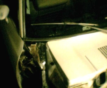

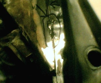

Found It!@! Removed hood hinges, used flash and drop light and found area clean.... Then removed quarter panels and the seam that had factory putty was leaking -- beware all desert cars that move to the rain! Thanks for all of the advice, will post pics as soon as I can. Mike.

here is where it was leaking from, both sides. Cleaned off old putty, resealed with 3m 5200 fast cure, a marine grade sealant that dries underwater -- highly recommended. Mike.
