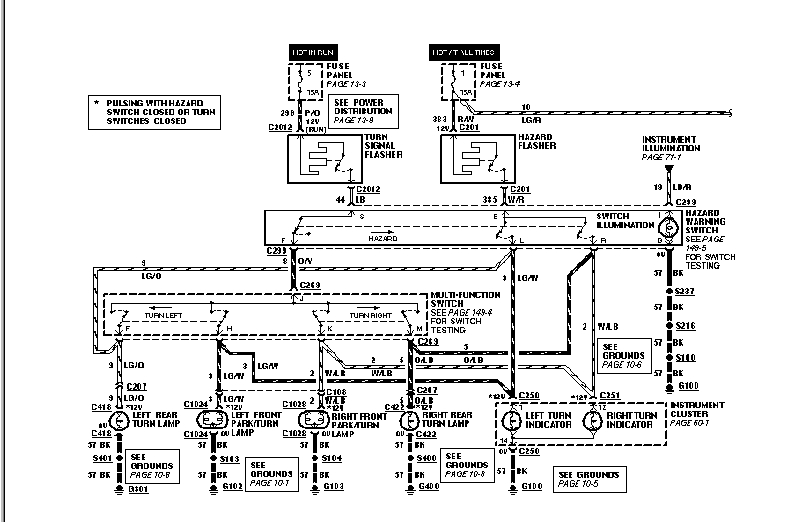

The turn signal circuit does not have a "relay".
What it does have is a flasher, which isn't anything but a auto-reset circuit breaker. When you turn on the turn signal, the turn signal light bulbs draw current. When everything is working correctly, they draw enough current to trip the auto-reset circuit breaker AKA Turn Signal Flasher. The Turn Signal Flasher cools down and the contacts reset to pass current to the turn signal light bulbs until it trips open again. Hence the flashing turn signal light bulbs.
The following diagram is for 92-93 Mustangs. You model year may be slightly different, but the idea is the same.

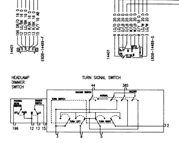

Here's the turn signal multifunction switch from an 89. The wiring should be the same from 87-89.
Before you think about replacing the multifunction switch with one from the junkyard, here's some things to be aware of...
A word of caution about multifunction switches is in order here. The multifunction switch (high/low beam, wiper, turn signals) are different for different years. 87-98 will work in any 87-89 car. The 90-93 switches only work in 90-93 cars. You can't put an early model switch in a late model car, nor can you put a late model switch in an early car.
Supposedly you can move the pins around to make the switches work in model years that are different from the car the switch came out of. I cannot verify that and haven’t tried it.
Other possible problem sources for the turn signal & headlight malfunction are the ignition switch, multifunction switch and the plastic shell that holds the turn signal wiring connector pins.
