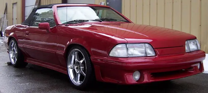

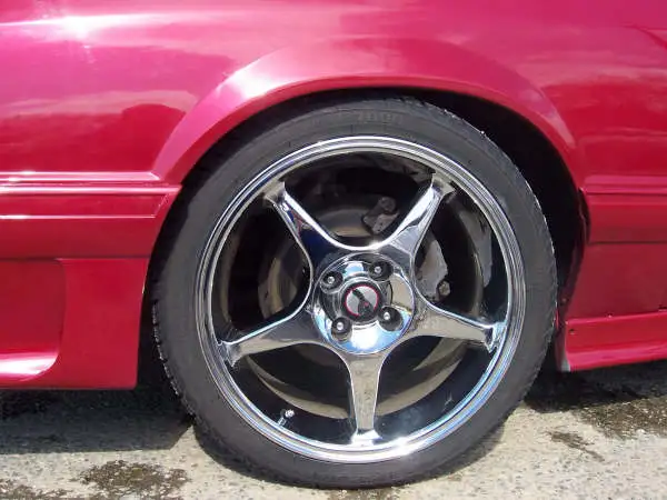

Anyway, a few McLaren pics:

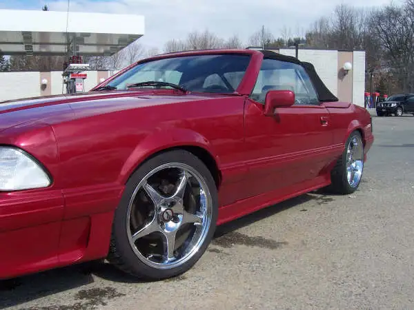

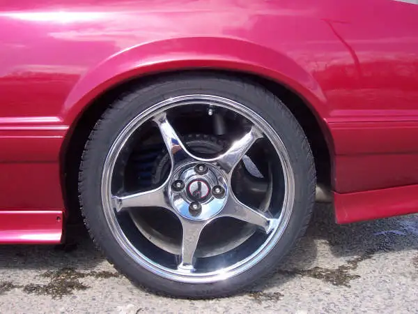

more

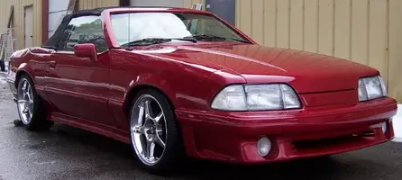

lastly
