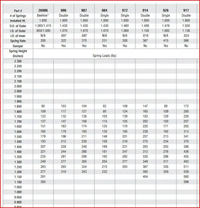

The cam sounds like it's a 281 HR. If that is the case it calls for 986 spring which is a dual set up with 322# of rate. I've attached the spec sheet so you can compare ALL the specs to what you have. If your springs don't match up then they need to be changed even if this is not the cause.
