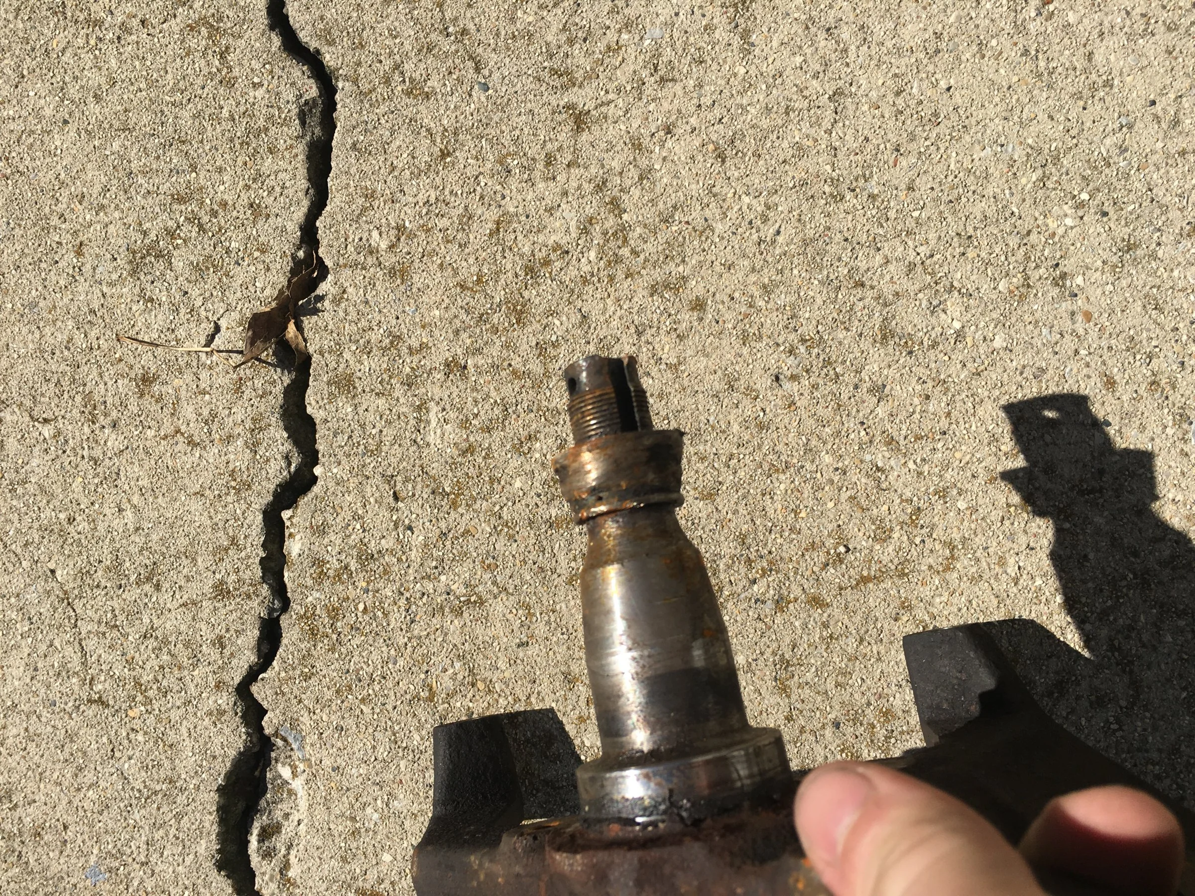

I replaced the rotar as well. Here is a picture of the first spindle that the bearing melded too. That ring that you see on there is not suppose to be there and it won't come off.

  • Oct 13, 2016
  • #13
Did you wipe the spindle off before you took the pic?
Yes I did, that pic is the original spindle that was on the car. The one I replaced it with is still on the car

Sounds like it may be better for you to buy a good used spindle. Did you install the bearing races into the rotor ? How did they fit ? I usually tap them into the rotor with an aluminum bearing installer. They should have to be tapped in and not fall out on their own.
The part on your old spindle is the inner race for the bearing. It's the metal ring the bearing rollers roll on.
The bearing themselves should slide on the spindle with no play. They should just slide over the spindle. If they fit the rotor ( races ) and the spindle ( inner race ) then the only factor is the type of grease.
