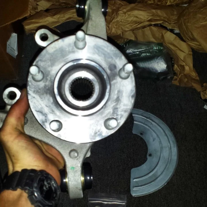

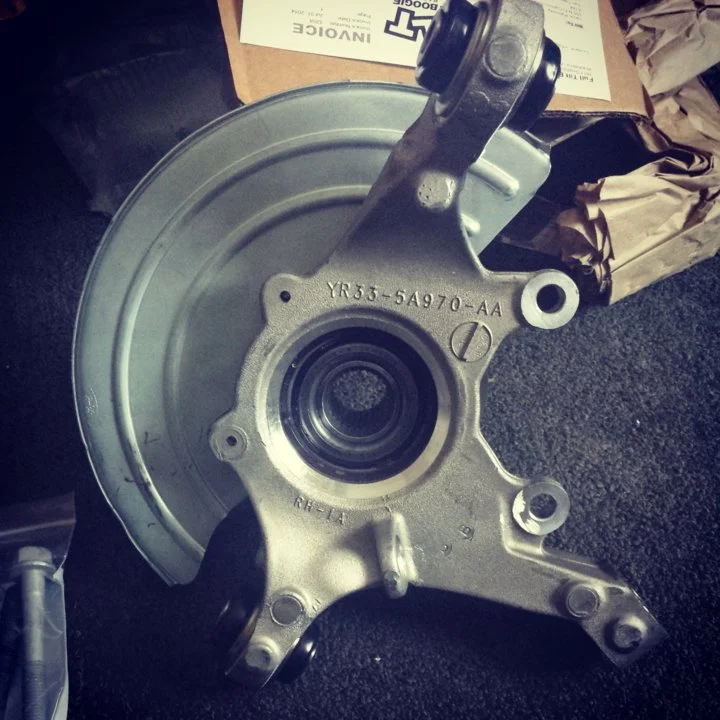

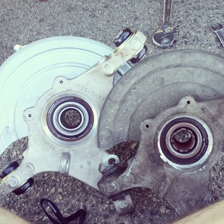

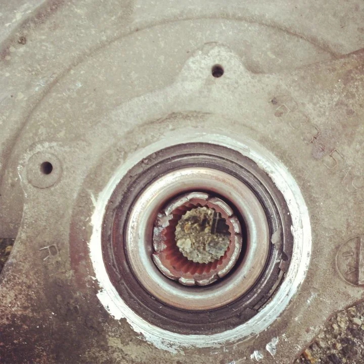

Sorry I've been gone a while but I have finally fixed and solved the problem. Turns out I torn up the hub assembly where the half shaft is spindle nutted down too. Then it began to wallow out the inside of my knuckle. Thanks to www.fulltiltboogieracing.com I was able to get the whole assebly for around $400. Just wanted to make sure an get this down for anyone else in the future who may have a problem

Been watching this thread for a while and scratching my head the whole time. Glad you were able to figure it out.
Thank you. It's one those things that not only are a pain because ford likes to discontinue parts but makes it hard for those who aren't to mechanical inclined but if needed I'll explain the whole process for whoever needs it when the day comes
