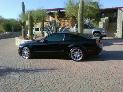

I have had success with (in this order of application) Mcguires #2 (by hand) or 3M coupound with a high speed buffer, 3M perfectit 3000 finishing polish with the buffer and lastly a coat of Mcguires Tech wax 2.0.
The pic below was taken a couple of days ago with my phone. I will show you better pics when the weather gets better. By the way this car has 62,000 miles...
