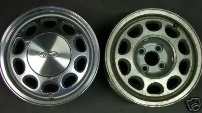

think it would be worth my time to do it this week? i got all week off and NONTHING to do...thinking i may polish my wheels after seeing these on ebay?
if i remember correctly there is a guy on here with an 85 or 86 5.0 coupe that has polished 10 holes on it?
Well, it can certainly be done, but let me warn you, it's a lot more work than just hitting them with the Mothers ball. I personally think they're badass but then i've always liked 10 holes.
Those also look like they've been widened.

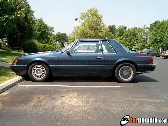

I used plain old Duplicolor Wheel Coating on mine (after i gave up on polishing them) and they turned out pretty awesome. I got tons of compliments. I think they would've look awesome like this with a polished outer lip, but these were too rough to do that with. I liked to run'em without center caps and with some nice lug nuts.

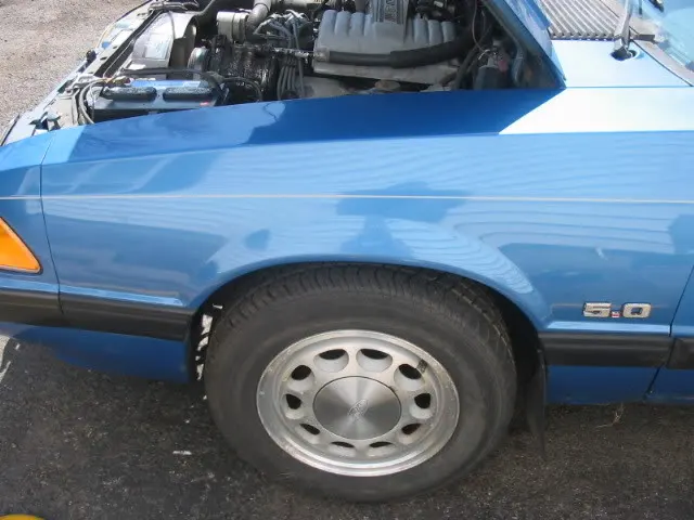

no cyrn rash or anything like that on these wheels...there in good shape..exepct for the clear coat your talking about...let me see if i got a few pics.
all of them pretty much look like this...
Go to Lowes and look through their paint strip section...i don't recall the name of the stuff i used but it was the more expensive stuff...you basically just want a really strong paint stripper. Get the stuff in a metal can, looks kinda like a charcoal lighter fluid can. You'll need a cheap paint brush also to apply it, and lay it on THICK and then it's just a matter of waiting for it to do its thing. Then you wash it off. I also used a good stiff scrub brush to get it off (not a metal one as that'll scratch up the wheels). It takes a bit of work but it WILL pay off.
