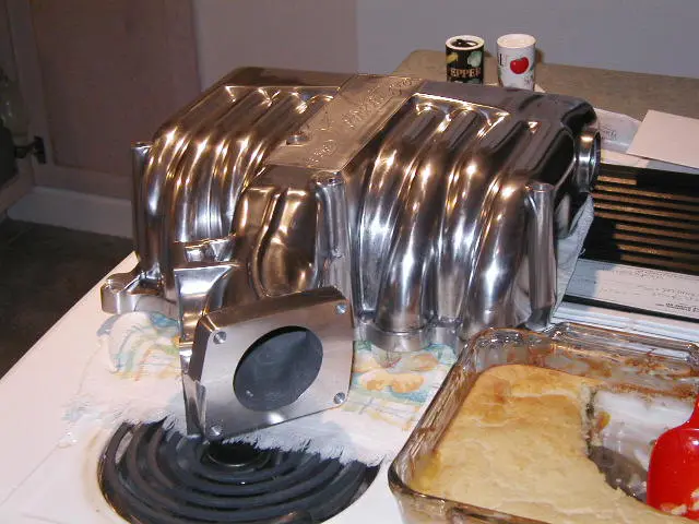

I am in the middle of polishing an upper. It's hard work because you sand and sand and it feels like you aren't making much progress.
<img src="http://www.mustangmods.com/data/8235/mvc010s.jpg">
<img src="http://www.mustangmods.com/data/8235/mvc011s.jpg">
There are two pics of what I have done so far. I'm going to go work on it more now.
