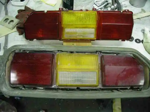

One word. toothpaste. It is a mild abrasive and it'll polish out plastic windshields and even glass.
Yup. Here is what toothpaste and a little bit to elbow grease can do. Both lights were in the same condition. Just toothpaste on a wet rag and start rubbing.
Tim
