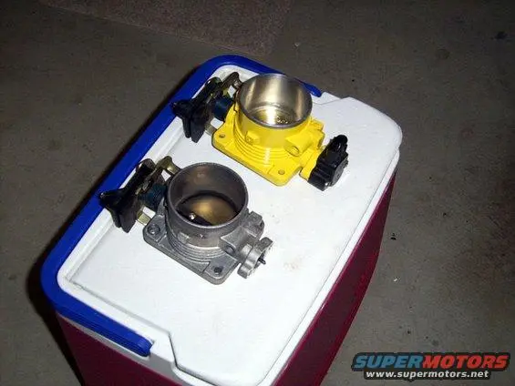

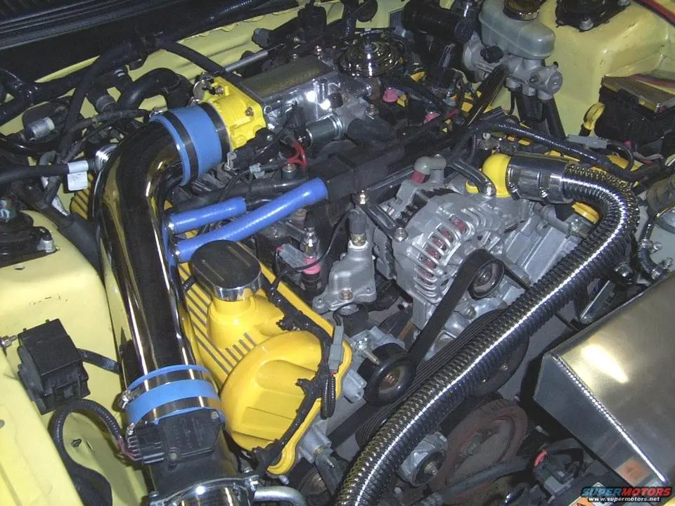

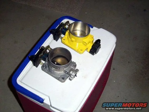

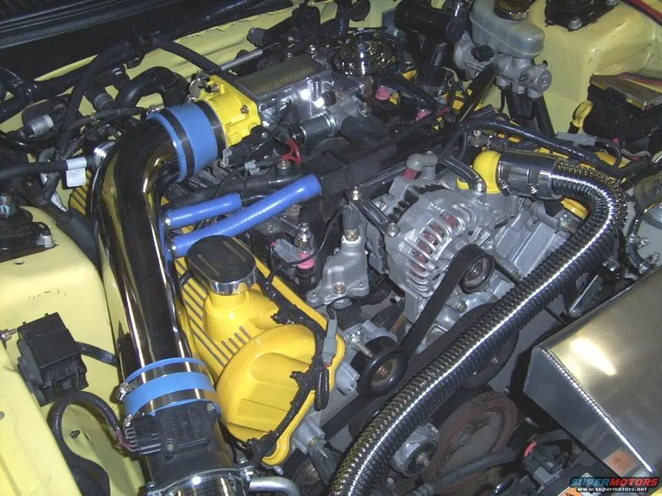

I picked one up from on eBay, also got the ported stock Plenum and had it Ceramic Coated also had my alt bracket coated.
