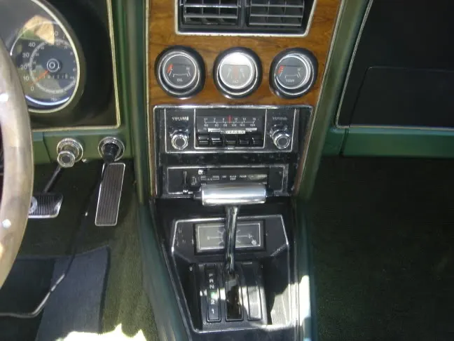

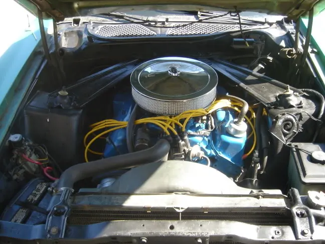

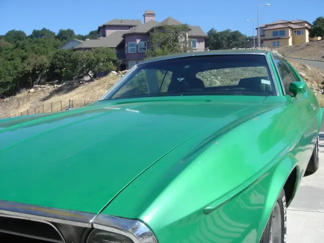

hi everyone, in addition to my Mustangs, I am gonna be looking at a 72 coupe tommorow, its has a 351C 2V, C4 and front disc brakes. the question is, is there anything I should be looking at that is considered a problem area for these cars. its a daily driven car with 6k+ on the rebuilt motor.
sorry, I was debating if I was supposed to post this in talk or tech, so, i did both. thanks. anyone own one? pics?? here's some of it
