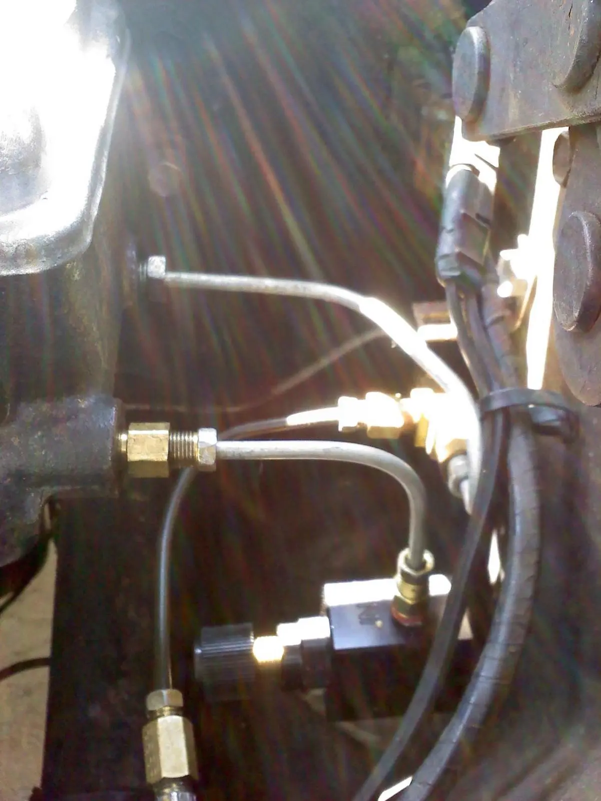

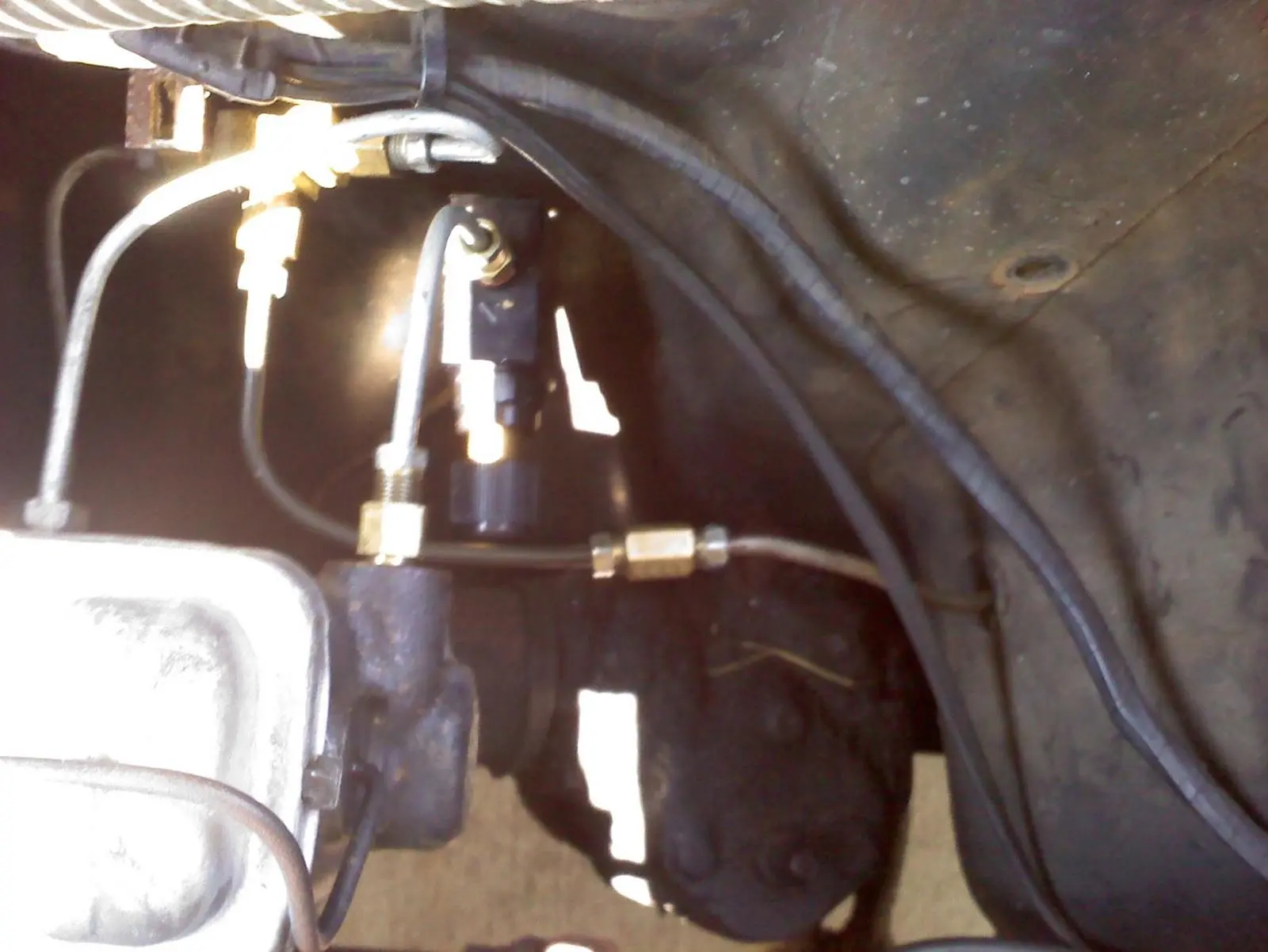

Ok so i recently installed a scarebird front disc conversion kit (hopefully not my first mistake) and the pressure was ok with the stock single bowl, but i wanted a stronger pedal so i installed a dual bowl. I bent up some new adapters and small fittings that i got from a local auto parts store, bench bled the MC and installed it. Now i have worse pressure with the dual MC than when i had the single! any ideas on why that is? one or two of the small lengths of tubing has a smaller diameter than the stock tube, if thats possibly a problem.
EDIT: 1966 289 btw
ya i will post a photo after work.. i used a new distribution block for the front brakes, and ran a proportioning valve out of the MC straight to the rear drums.. could my refurbished MC be bad even though its not leaking at all?

thats strange then that scarebird doesnt aknowledge any issue with using the 74 maverick MC, or why he even recommends that specific MC if it doesnt work.
