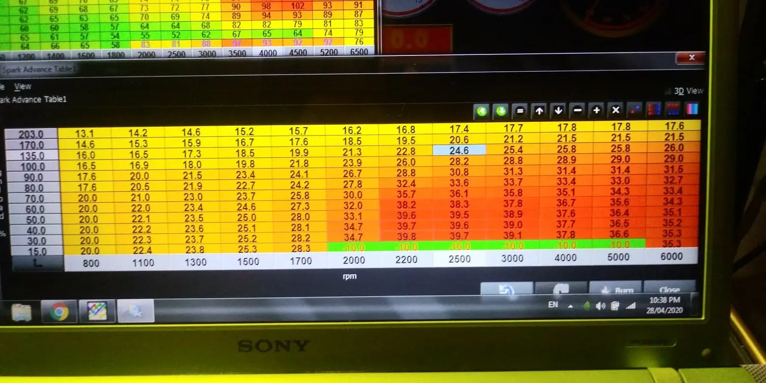

ok so i kno this sounds stupid to ask but lol.... id be setting base timing to "0" so i can retard the timing to -10 since thats the limit on my balancer, since you cannot command timing lower then your base timing correct??? or am i just commanding zero degrees under decel.
also is this ignition table in the ball park haha.. im not exactly sure on how much timing to pull at first. never did this :poo: before haha
"edit" i guess i couldnt actually pull that much timing to match -10 since i cant command less then my base so ya i get the 0-1 base timing thing now.. so that ignition table is useless haha would have to be 0 not -10
