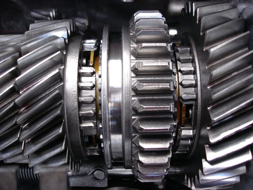

This is what the teeth look like.
1st gear is to the far right and the middle gear is the slider. Gear to the left is 2nd. notice the nice pointy teeth where the slider slides onto. Notice how they are angled. BTW, this is a 40K mile 1985GT t-5 :)
When you start gridning gears (when the synchros get worn or when you suck monkey balls at driving) they start to round over like this. This is 2nd gear out of a 1992 t-5
COntinue and then you will get popping out of gear.
