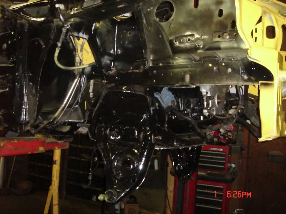

I sprayed it under the entire bottom of my 81 notchback. Looks beautiful! Cleans up with just a quick spray of water when it's dusty. I also sprayed my front LCA arms after I had new bushings installed. They still look brand new and shiny as hell.

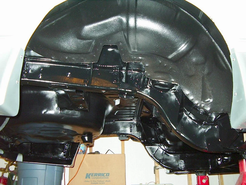

PIC of LCA's
Underbody

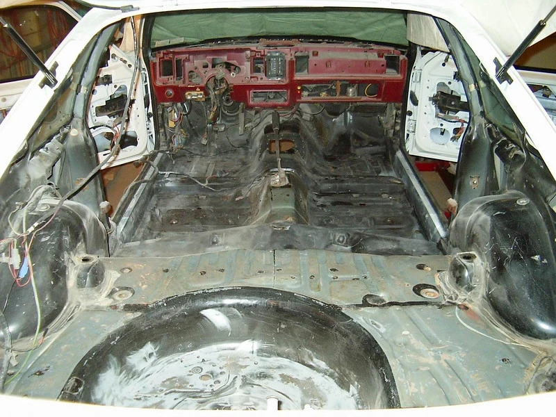

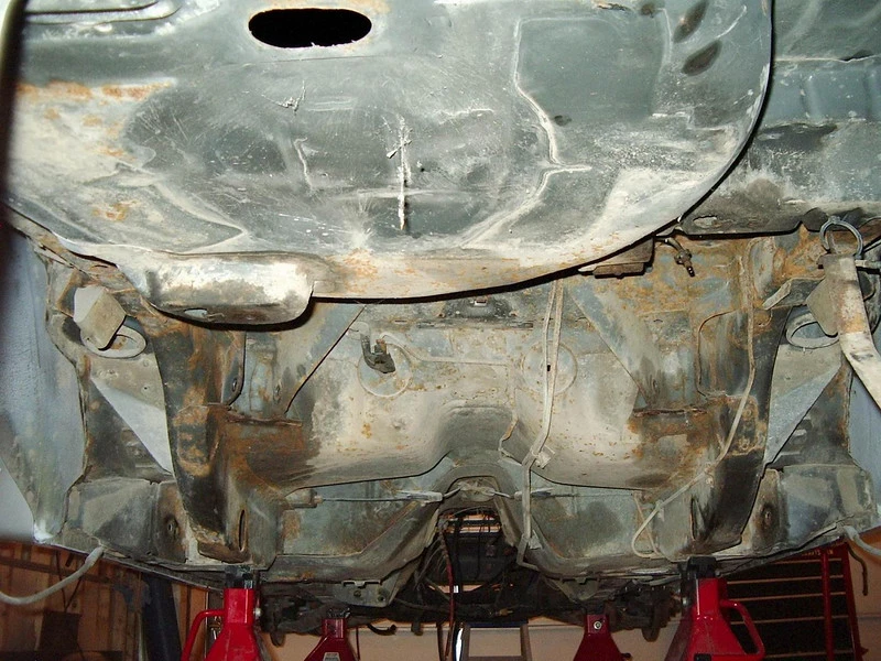

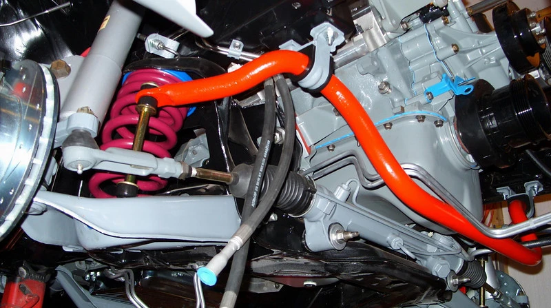

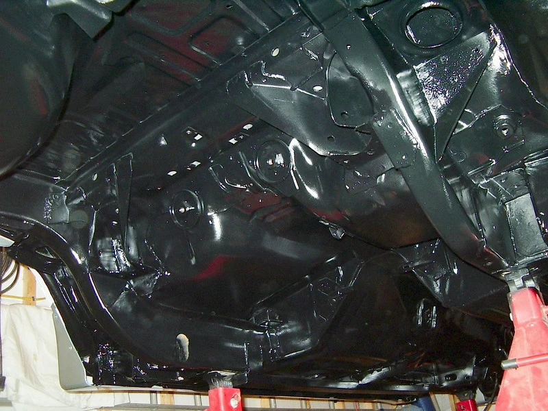

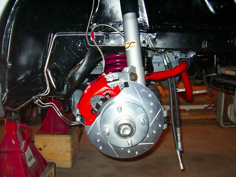

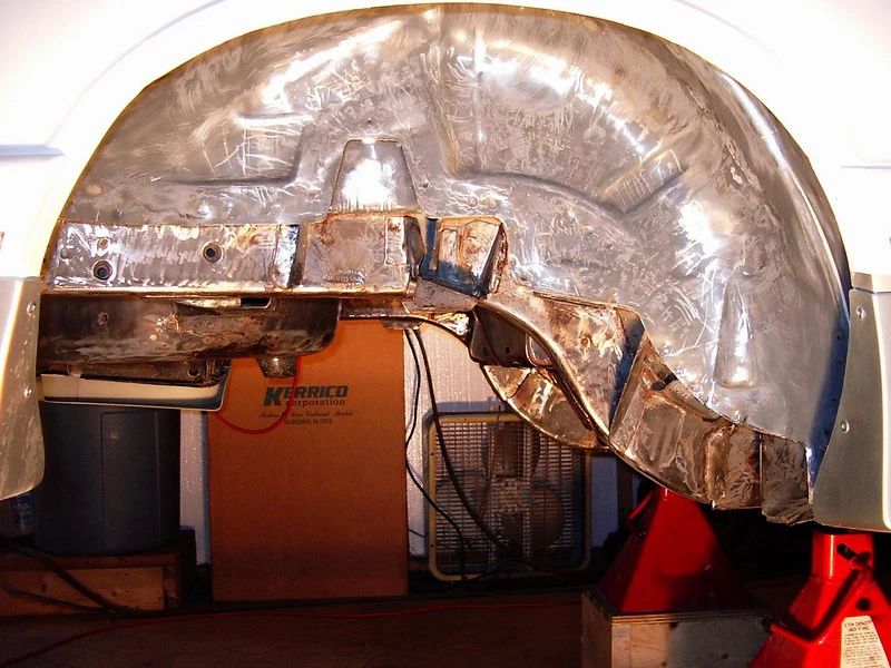

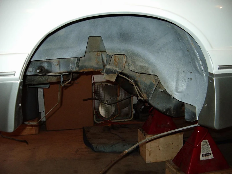

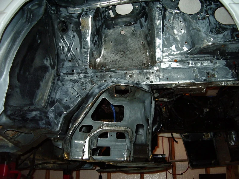

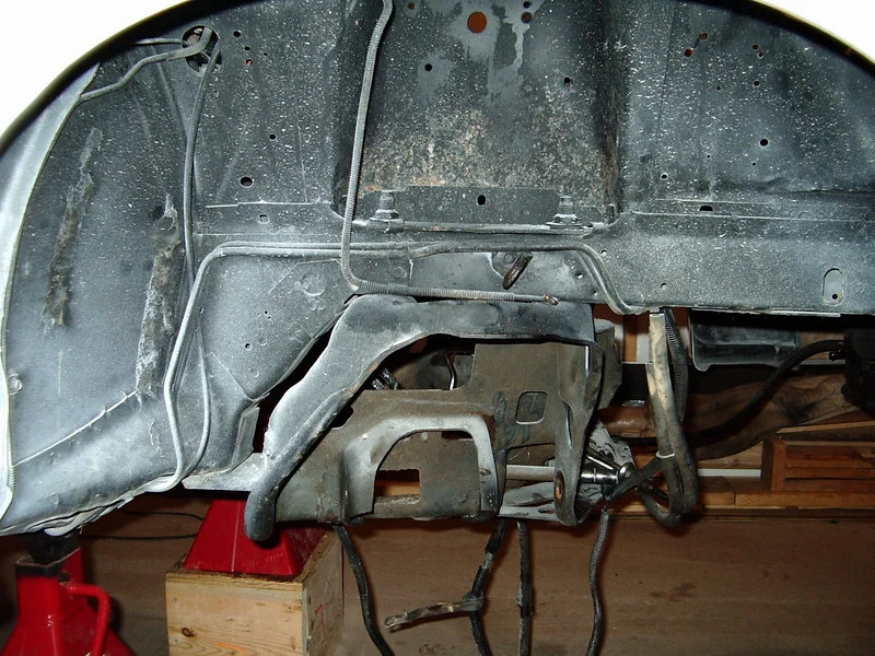

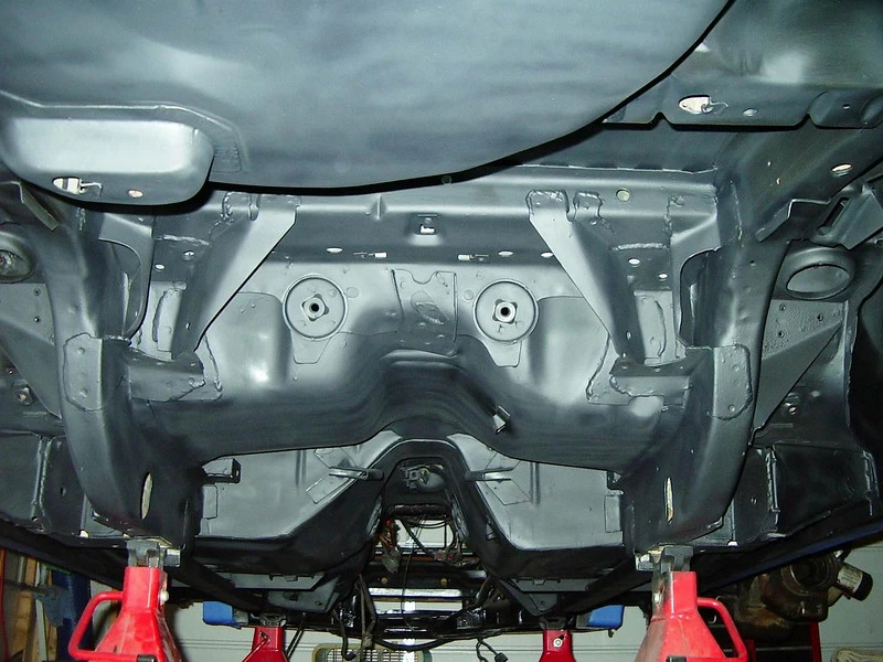

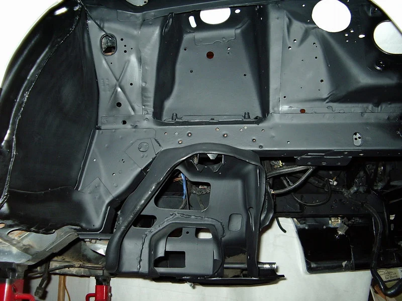

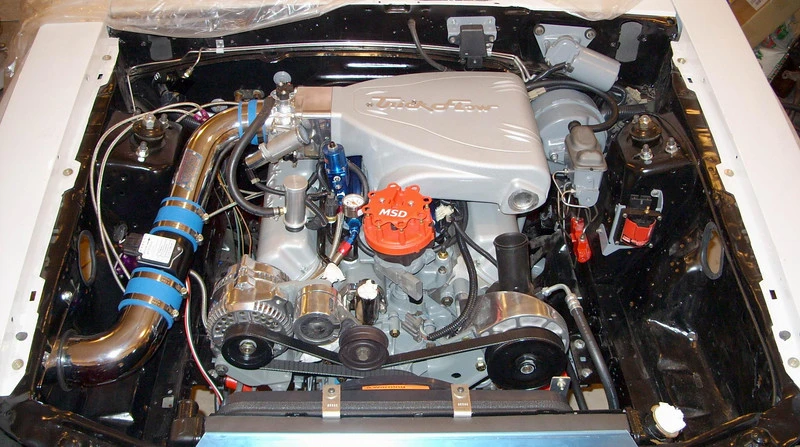

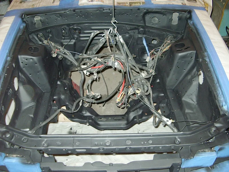

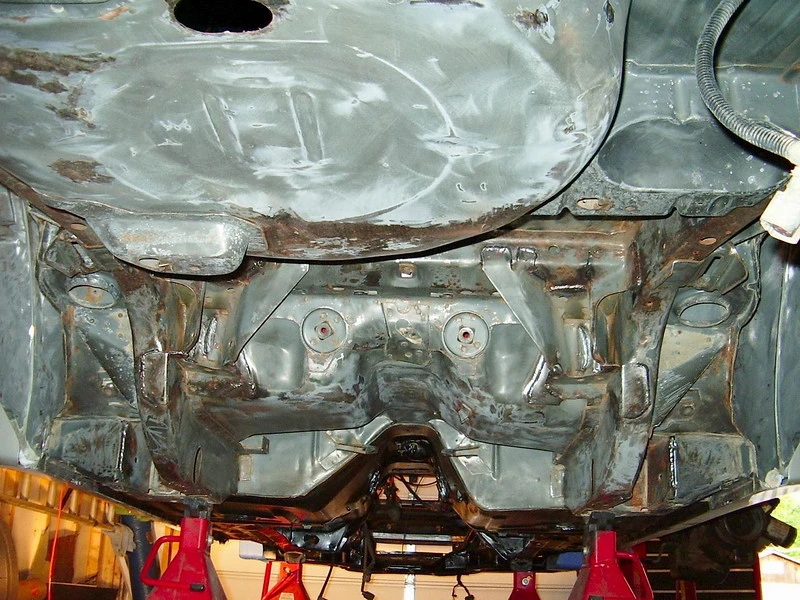

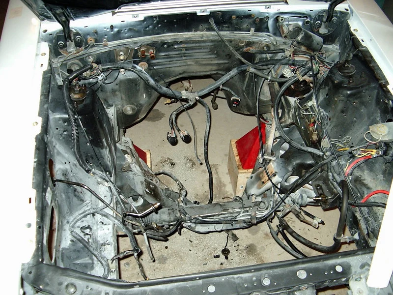

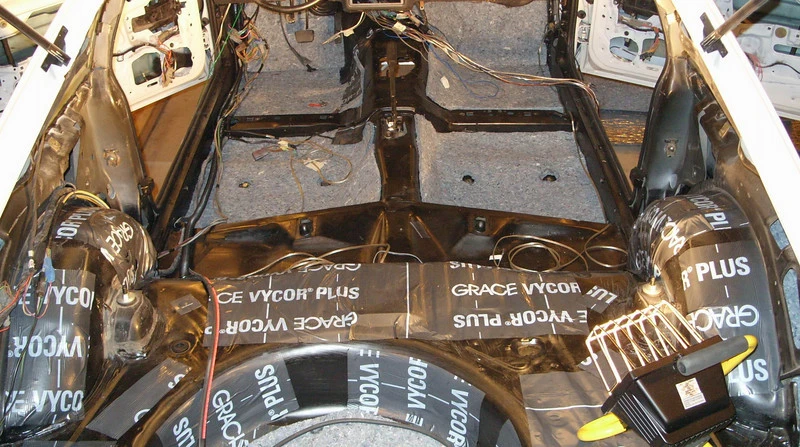

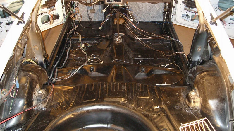

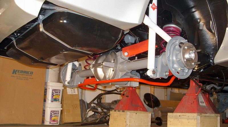

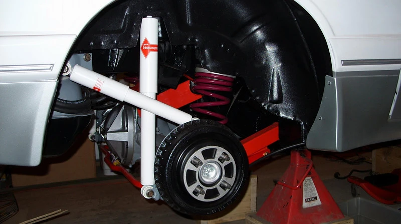

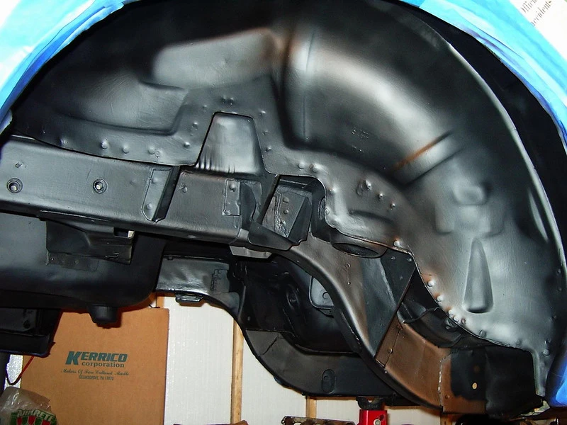

I stripped my engine bay and the whole underside down to bare metal and applied "Chassis Saver" (very similar to POR15) with a brush, primed it, then painted it gloss black. Stuff works well.
before I started:
Almost stripped to bare metal:
After 2 coats of Chassis Saver and 2 coats of primer:
Painted gloss black:
Everything installed:
