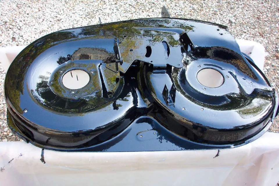

I tried POR15 "Hardnose" paint a while back on my mower deck. It took eternity to cure - like a week! The benefit of the long cure time is that it is self-leveling, meaning that the brush strokes vanish leaving a super smooth surface. Unfortunately this also leaves it more vulnerable to dust and debris contamination prior to curing.
