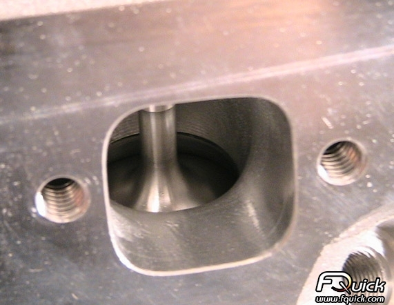

Inspection of the Typhoon reveals the cost savings. The intake is nowhere near as cleaned up as its Edelbrock counterpart. The port openings are irregular and inconsistent in size, and there is considerable casting flash in the runners. Visually it appears the mating surfaces are square, but we wouldn't be surprised if they run wider tolerances than domestic product. Nevertheless the problems are not insurmountable. Most guys may be willing to sacrifice a couple hours of cleanup time with a die grinder for $200 in the bank. We spent a little time gasket matching the port openings (see below), and cleaning up excessive flash.

I agree with 25th, the heads are probably OK at your performance level. Being that it is a supercharged motor though, you might see some benefit from porting, but it might be more work than its worth.
I also agree with Notchbck93, a little inspection and cleanup of your Typhoon would probably go a long way.

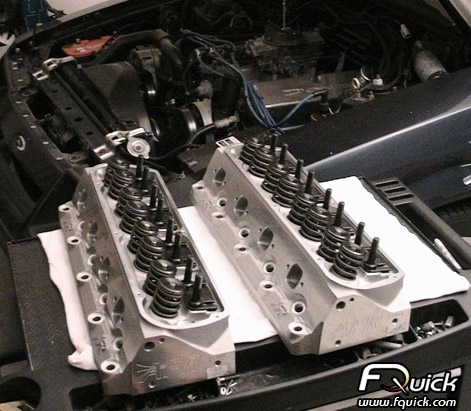

I actually have a set of "competition" AFR 165s. I spoke with Tony at length about these at AFR who personally designed the porting program for these specific heads. The 165 comp heads come with more porting, 7/16" studs, and heavier duty springs.
Part #1404
Air Flow Research
I still have a stock 93-95 shortblock and that's why I went with these heads but they have just a little more grunt than the "standard" 165s. I'm also running a mild Lunati cam that I know works well with these particular heads...can't remember the spec other than the .525" lift. Basically running the same combo that MM&FF magazine did on their 85 Capri project a while ago. Using a 575 Demon and Weiand stealth intake they made something like 317 hp. to the wheels. I went further with that and am running all the same stuff except a holley 650 dp which i think is comparable, long tube headers on mine (shorties on their car), a Canton pan and scraper, no accessories except an alternator so I'm hoping to lay down even more power with my 85 notch.
Anyways - I would suggest sending the heads over to Tony and have AFR tweak your existing heads if you want to do more with them?

MY point was that porting your heads won't do you a lick of good if you have a dirty typhoon on top; clean that up first!
