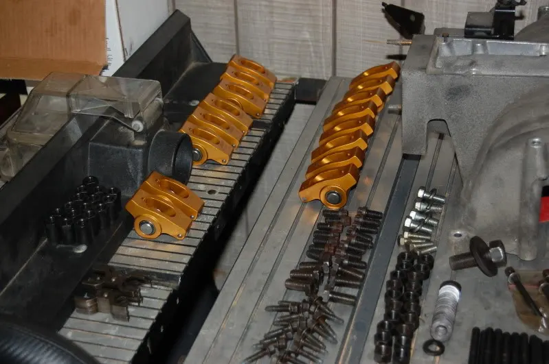

I've decided that for right now I would like to keep a tight budget since I only have $155 in to my GT40 Upper and Lower, B303 Cam, 24lbs Fuel Injectors, and 1.6 Crane Gold RR(if I use them, if I can)that are waiting in my garage to go on the car. Not counting what was already on the car when I bought it, bigger maf, 70mm tb, longtubes, h pipe, 2.5 mandral exhaust with flowmasters, C&L Air Meter, Tremec 3550, aluminum driveshaft, pro 5.0 ss, 5 lug swap, disc brakes off a 2000 gt and all the suspension work. I plan to switch to 3.73 gears very soon. If I add the stuff not on the car, would that be a pretty noticeable difference?

p.s anyone know if I can use these crane gold 1.6's on e7's?What do they add to a motor(I know this is a dumb questions but I'm still learning)
