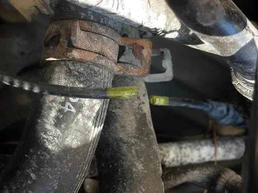

Would it happen to look something like this:
I popped the hood and found that line pretty severed and someone had duct taped it. After putting a tiny bit of force on the duct tape it just popped right open so I'm assuming this is the hvac vac line you all are reffering to.

That does look like a winner.
If you have a piece of rubber vac line that has an ID that fits over the OD of your OEM line, you can splice it. The rubber splice would function like the duct tape did (albeit much better). I've done this and it works decently as a temp fix.
The ducting for the vents is controlled with vacuum. Have you ever gone to WOT for a bit and noticed your vents stop blowing on your face? Once the vac reservoir is depleted, the HVAC controls lose vac (as happened to you with your open vac line). The result is the default setting (air out the windshield vents).
