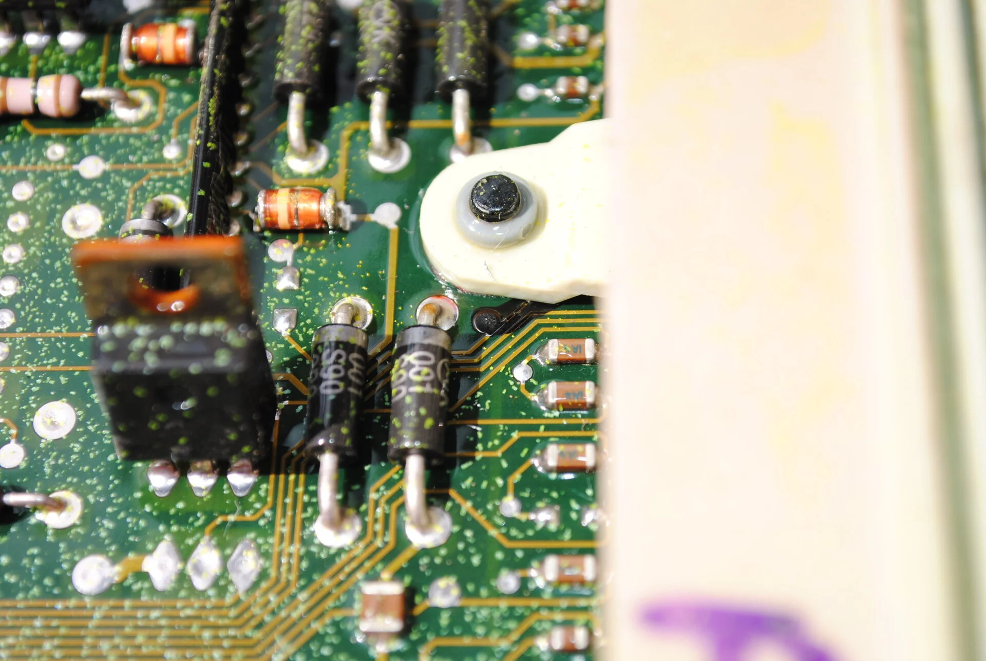

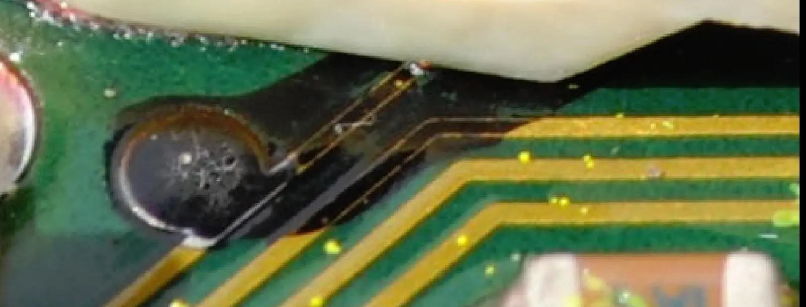

I opened the ECU and looked at the board for obvious marks. I did not see anything on the board for Pin 29, but there is a spot that looks like a possible burn mark near it and it's bridging three traces. Before I get out a sharp instrument and scratch off the mark to isolate the traces, can you guys look at my pictures and tell me if what I am seeing is normal? on the back of the board I drew an arrow simulating where the suspect burn mark would run. on the front of the board I circled the suspect mark. I'm curious because I don't see anything wrong on the back. So is this mark normal?

Does not look burned to me in the first 2 pics. The final pic, i can't really tell. Need a few more views of that.

Thanks Mike I'll try to get a better view. The mark is black not silver. But it's under the coating so for all I know it really is silver. As far as replacing parts

I opened the ECU and the only thing I can find is that black mark that I circled in the third picture.
The black mark does look suspect but I just can't tell from the photo.

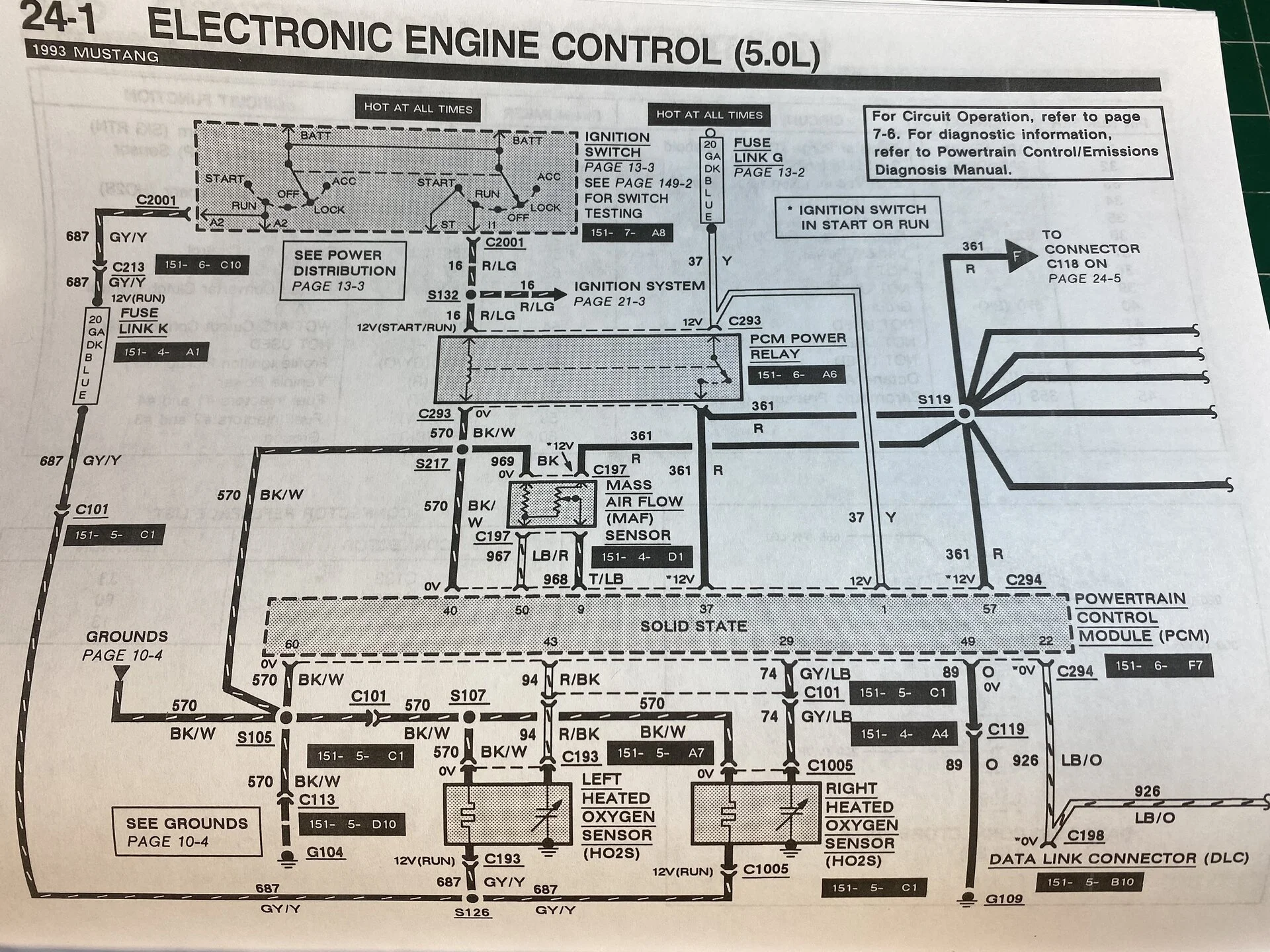

I think you are on the right track in verifying the harness and checking continuity from the ECU to the connection.
Check continuity and resistance on pin 29, (and compare to pin 43) as well as checking for good power on the Gray wire at the sensor, and a good ground on the black wire.

I dragged my old DSLR camera out of the closet to see if I could get better pictures. When I zoom in I'm starting to think the mark is the coating and not the solder melting and running.

It is hard to tell from the picture to me but that does not look burned to me from the picture. Those traces look intact. The dot looks like a test point. Only thing I can think of is that someone used a sharpie for something and did not clean it off before the board was reflowed or coated. That black mark looks too crisp to me. If it was a burn, you would see more haloing in my opinion. You should be able to clean the conformal coating off a couple of the pads between the traces to check continuity.
I think I'm getting closer to fixing it. The harness side of the O2 sensor plug is a replacement with 4 wires. Apparently when I repaired the melted harness I mistakenly spliced the unused fourth wire from the oxygen sensor plug into the harness. So the sensor was generating voltage, but it was going into the unused wire on the connector. Had I not had the computer out so I could run continuity tests and compare to the known good left side plug I probably never would have found it. The light doesn't come on instantly now but it did still have a 41 in memory. Now I'll probably have to swap sides on the harness and see if it trips a 91.

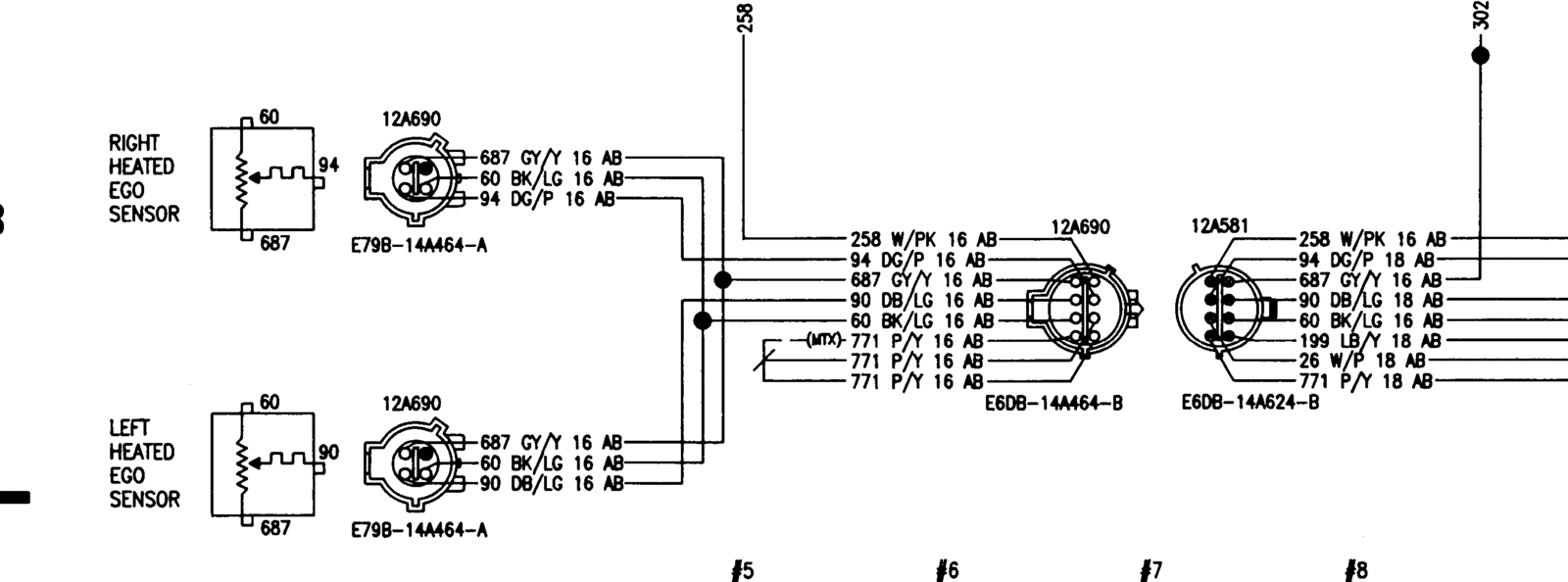

Thanks for all the help and the diagrams. I'll probably drive it for a while now and see what happens before I do anything else.
