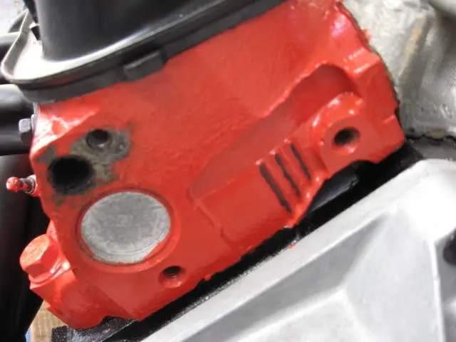

Davis3 is dead on. The shortblock is identical on all 94-95's. The Cobra's basically have a H/C/I swap over the GT with a better tune in the computer. Take a look at these photos from my Cobra conversion. Branted, my heads are painted red w/ black headlights, but you can see the GT40-specific markings.
This first photo shows the "GT" in the right corner of the heads. This is the driver's side cylinder head, the passenger side will have "GT" right next to the alternator.
I don't have a photo, but the letters "GT" are in between the 2nd and 3rd rockers, I believe. The ends of the heads have three lines, highlighted in black in this pic:
