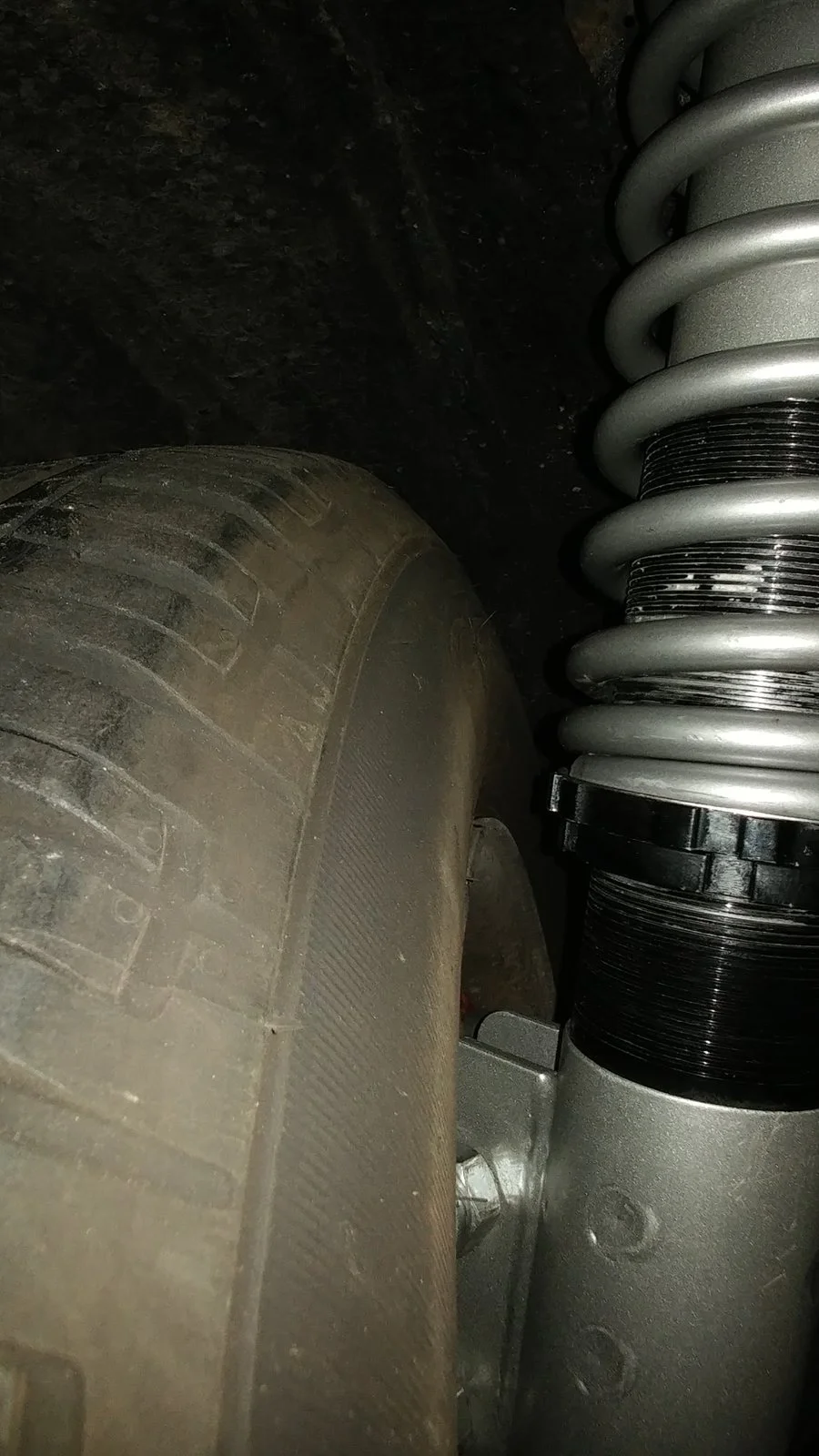

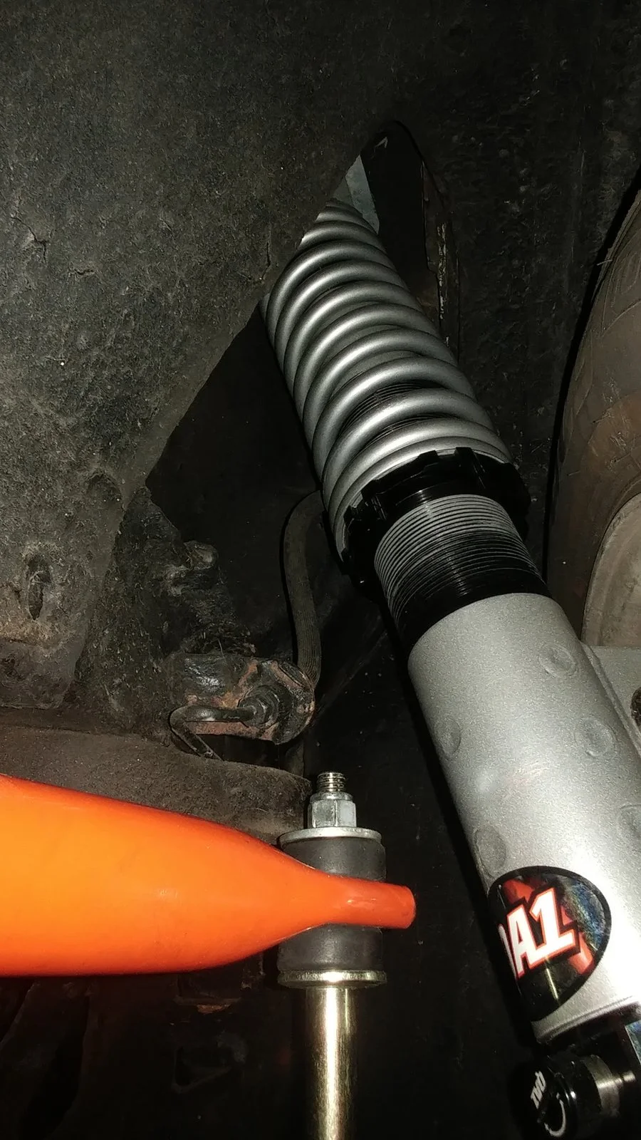

Finished up raising them a bit, attached a couple pics afterwards. Same noise occurred.
Actually the noise happened without the wheel on, I uploaded a couple videos to detail this.

You can really hear the noise when I drop onto the race ramps, since both sides are generating it.
If the engine is still out of it just loosen up those control arm bolts a little and see if the sound goes away. You need to have full weight on the control arms when torqued down. That means wait till you have the engine in, I always leave a checklist of things to check taped to the windshield when doing multiple things on a car.
