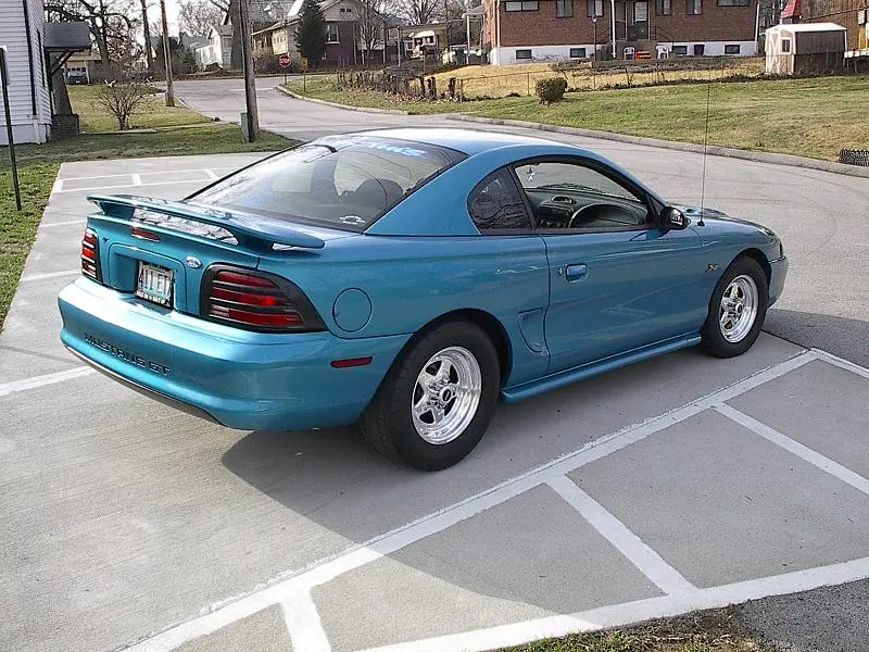

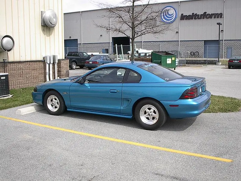

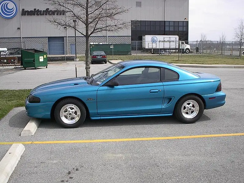

post SN 95's with Weld prostars
well, for starters with any Weld wheels you need to upgrade to longer wheel studs to be safe. As far as the front wheel fitment, you'll have to grind the caliper crossbar a bit and use a 7/16" spacer, or totally remove the crossbar and run a 5/16" spacer. I used a 4" angle grinder on my caliper and "flattened" it out (made it thinner) so I don't have to run a spacer at all
