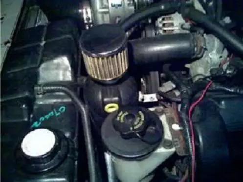

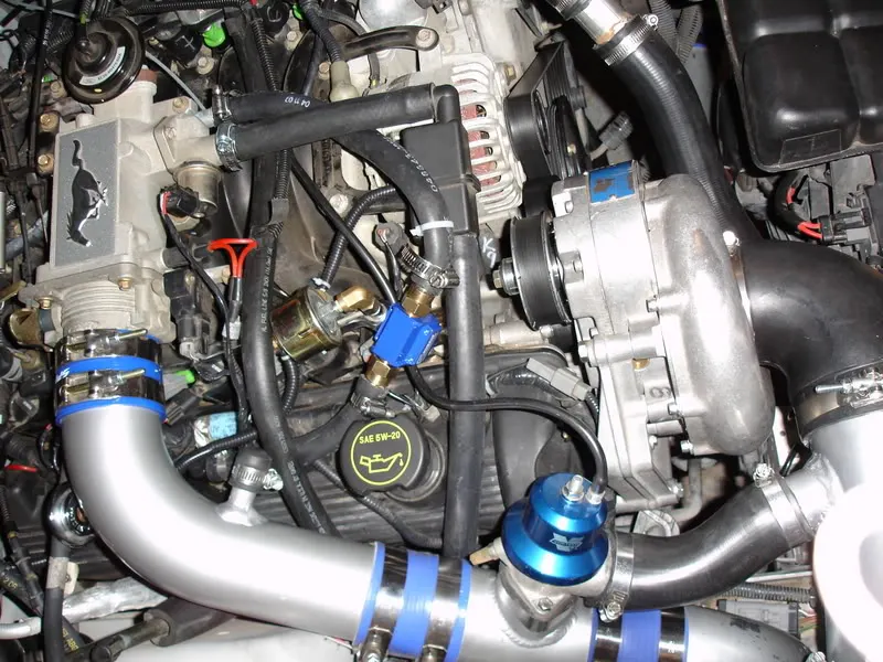

This is my setup. I only have one on my PCV line. I recently rerouted the hose and separator behind the plenum for a cleaner look. I have been curious about puting a breather on the driver side valve cover.. I just want to clean up under the hood as much as possible!
Maybe someone else will chime in...

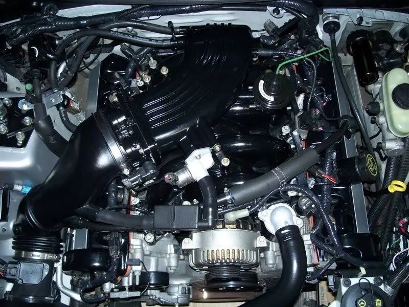

This was my set up on my stock intake,you can see it just near/behind the driver side cam cover on the firewall....

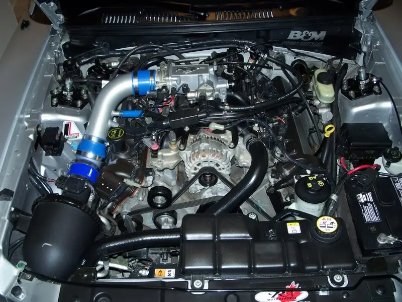

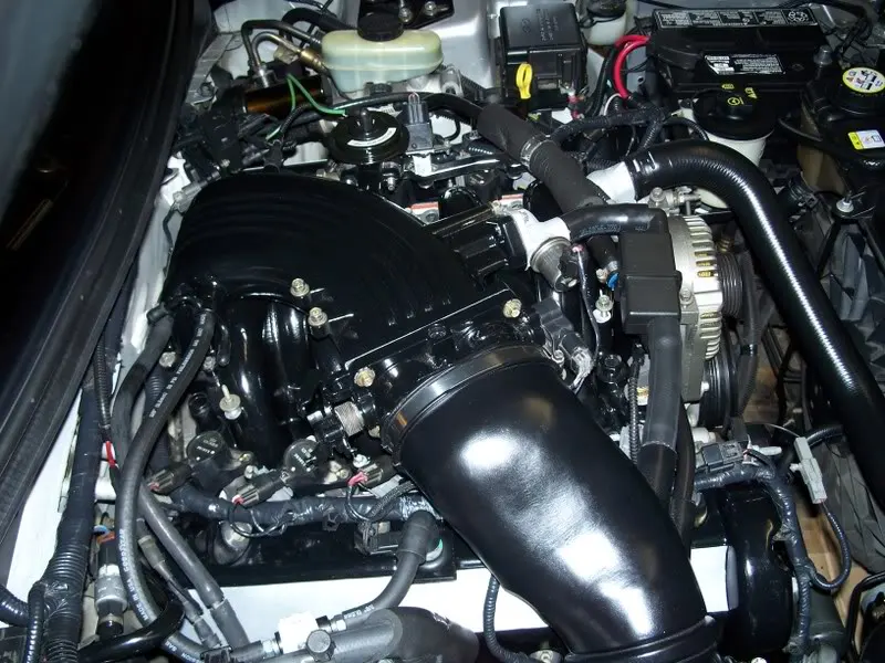

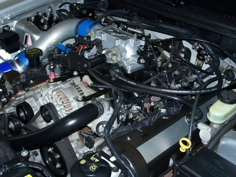

And now with the Bullitt intake,which you can see it hanging by the passenger strut tower.....

I empty mine every other week roughly,once it gets 1/4 full,that is when i like to empty it.
As for the cam covers,they are the stock ones.In the first 2 pics,they are my stockers that came on my GT,and i made those plates for them,and the last 2 pics are Ford stockers that i got from the wreckers cause i needed the oil fill on the driver side,and made plates for them aswell.:)

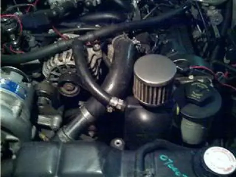

In my 1995 Talon TSI AWD turbo, I use fram fuel filter to catch oils, and change it out every time oils change ( only $2-$3 at walmart ) I dont know its work the same way as the mustang, I show you the pix on the talon if I can find it.
Edit : Here its, cant find my car pix, this is friend car ( guy that show me how to do it ).
